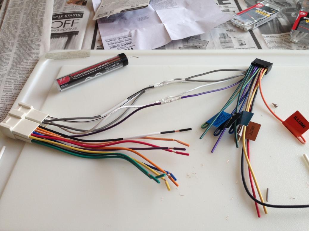

Step One: connect the metra wiring harness to the Kenwood harness. I soldered and heat shrunk the wiring harness (see pic), but I think that the cone-shaped wire connectors that crutchfield sells would have done as good a job. As mentioned many times on this board (thank you to previous posters BTW), you must connect the pink wire in the truck to a powered wire from the new head unit. Be sure to consult the card that came with the Metra harness to determine which wires you need and which you don't (i.e., power antenna). My first attempt by using the harness wires was unsuccessful (no rear speakers), so I merely cut the pink wire at the harness in the truck and connected it directly (outside the harnesses) to the remote lead from the Kenwood harness. Worked fine.

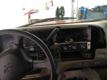

Step Two: remove the dash trim. This is easy to do, but you must use caution so as to not pull any wires from their housings. Be sure to put the gear lever in low to free up some space, and then carefully pull on the dash trim and it will come out without much pressure. My truck had 4 housings that must be disconnected: the light bundle to the left of the steering wheel, two for the 2WD and 4WD connections, and a 4th for the foglights. Most have a small tab that, when pressed, will free the bundle from the housing. Watch for the hazard button on top of the steering column as it is in a vulnerable spot.
