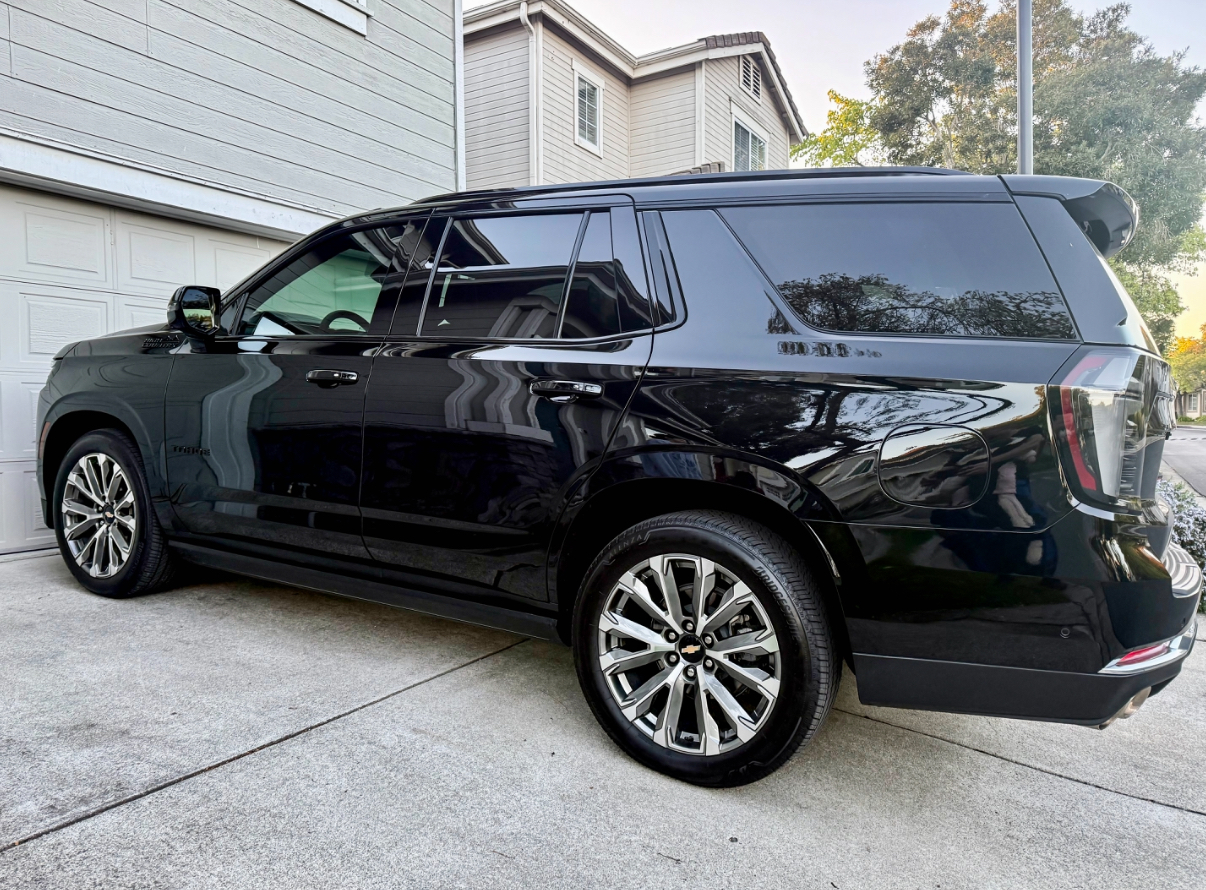

Started blacking it out, next up will be replacing all the chrome window trim and roof rails with the black oem parts from the RST.
Looks awesome! Have you replaced the window trim and roof rails yet? Any advice removing them? If I understand correctly, you have to drop the whole roof liner to get to the mounting hardware. And on the window trim, the lower pieces look to be held in with a few screws, but the vertical trim piece has plastic retainers that look like will have to break to remove?
I plan to do the same mods when I get my High Country in a few months.

I purchased all the oem parts, awaiting scheduling at my body shop for the install.
T
tyet
Dec 27, 2024
34
50
Black RST roof rails, window trims, and door handles installed. Replacing the roof rails did require dropping
the headliner. Next up is replacing the front grill and chrome bumper fascia trims to all black (again from the RST).
