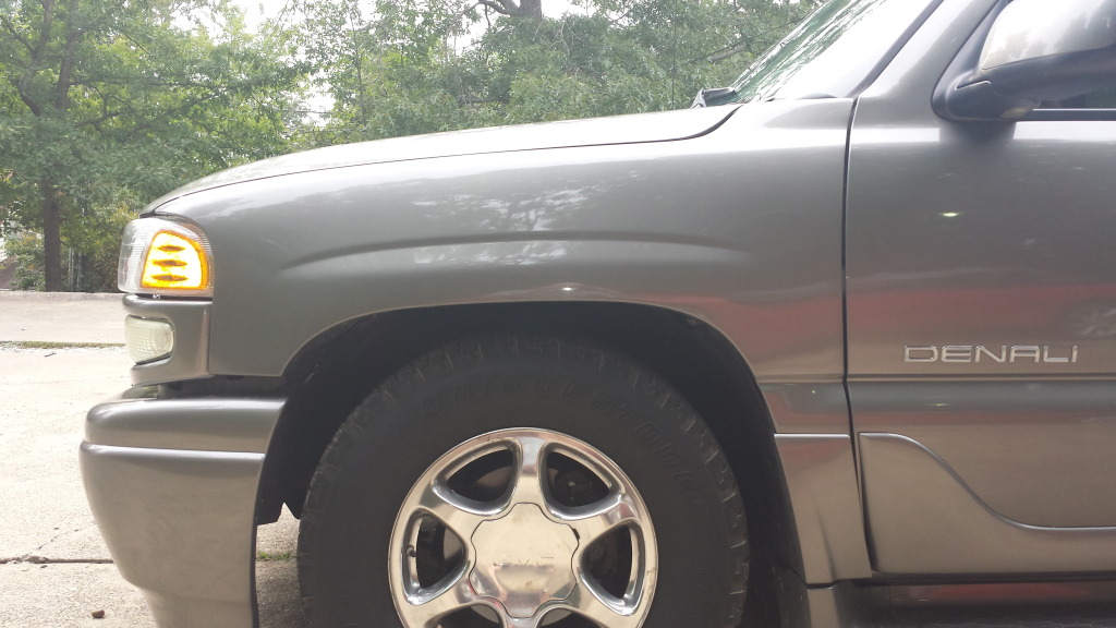

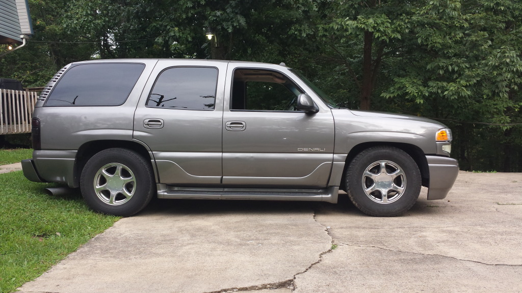

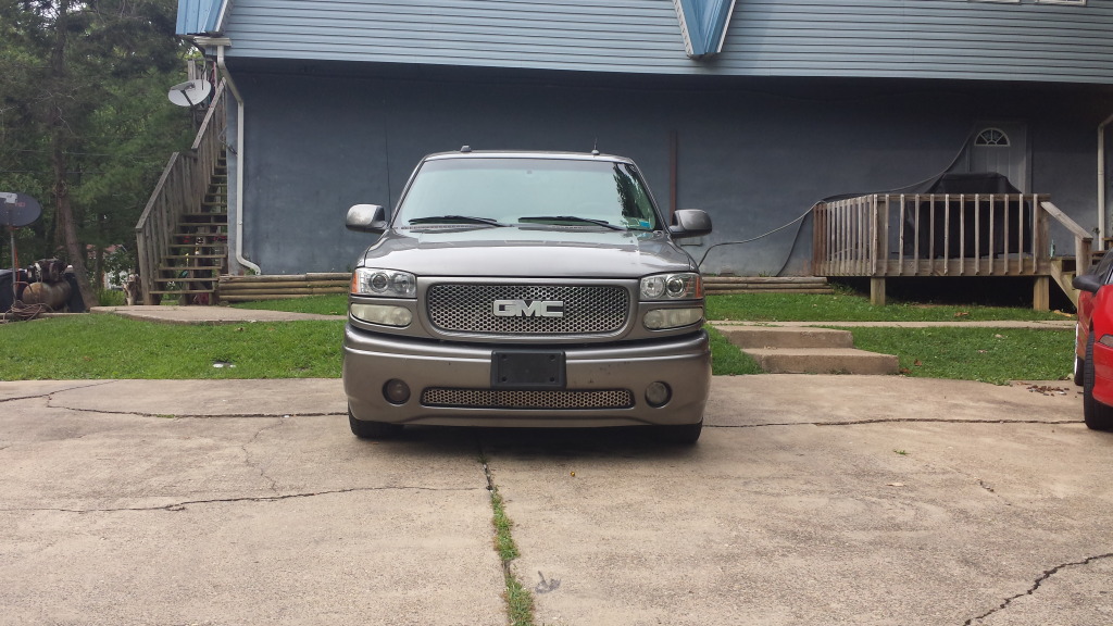

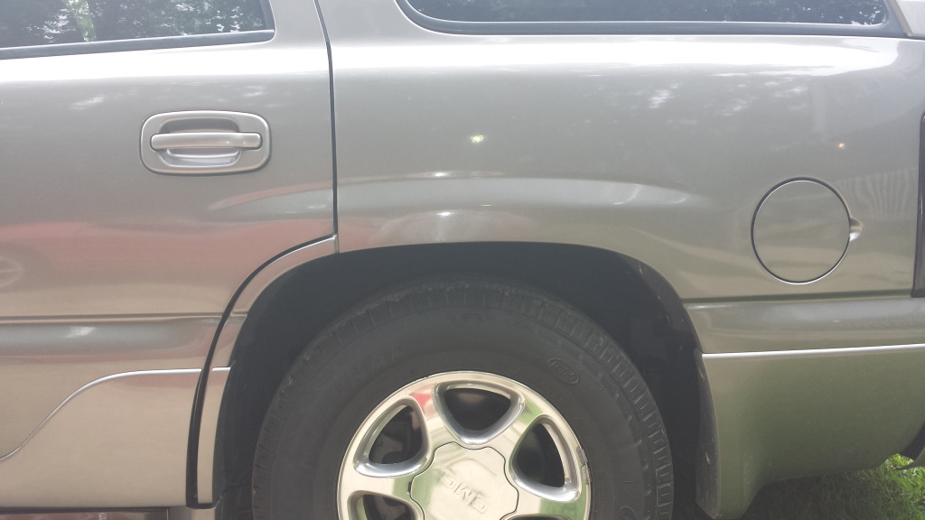

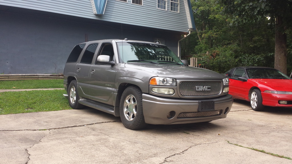

Now, first issue, as you can see, the vehicle has been dropped. The rear has some blue springs is all I know about them. They did not use shock extenders or anything. The front appears to be dropped by the torsion bars since the front tires have obvious negative camber. We want the factory Z55 suspension to perform properly so we realize the drop has to go. No biggie. I've included pics so someone might be able to tell me how low the drop is. Because one thing I've never messed with are torsion bars. How will my guy know how much either way to get the front end back to factory height? 20140910_173225.jpg

Looks like a lot. maybe a 3/5 even. Does it have OEM front spindles or do they say Belltech or McGauphy on them?

On the drivers rear corner, do you see the air compressor? Going back with OEM shocks, struts and possibly fixing the air pump could be $1,000+ when you could go with a great aftermarket (non air ride) setup for half that.

looks good, haha. does it not ride good? It deff looks like its more then just keys.

Well, we kinda like the stance but it rides terrible! The rearend is basically held up by the springs. They left the factory shocks on it without even using extenders so now the shocks are blown all to hell. Same thing on the front; factory shocks and it constantly hits the bump stops.

Kinda sounds like it was dropped all wrong. A properly dropped rig will ride very nice. I get compliments on my ride quality all the time so it is possible to get a nice ride while being lowered.
It sounds like It's got lowering keys in the front and I'd be willing to bet the rear still has the factory bump stop attached to the frame. If so, it will bottom out easily and ride like crap. Research the "free travel mod" if you want to stay low and have a good ride.

Ok, so back to the Denali. I got my head under it as far as I could (actually, I can't get my head under the damn thing) and looked around to see what goin on in the front. We already know that it's got drop springs with busted factory shocks out back. The front is completely stock. Spindles, control arms, and all that jazz. Now that I understand how the torsion bars and keys work (even with my automotive back ground, I didn't fully understand them until this forum. Just the pics of parts was all I needed) I looked where the key bolts are and while I can't tell what keys are on it, it's obvious where some of, if not all of the front drop comes from. The bolts are backed out so that on the drivers side, from where the threads enter the hole, to the top of the bolt head is at least a full inch. On the passenger side, I didn't even move to that side because I could tell from where I was that the bolt on the passenger side is actually backed out farther than the one on the drivers side. My question? Is it possible to drop the front end that friggin low, on stock keys, by cranking those bolts out that far? I ask because I'm going with the Mcgaughy 2/3 deluxe kit with the spindles and need to know if I need to track down stock keys to get the proper height of the kit. So let's say the truck currently has 3/4 ton keys, it will be lower than the kits advertised drop of 2in, correct? If so, I'll need those stock keys.

Couple of things. No way they took stock keys that far, there isn't enough adjusting room and even if there was you'd have more tire lean. Second, it seems as if they have the keys done and THEN they still went to far (going for level height no doubt). But, to me the negative camber looks like complete poo. So they took a 1 1/2"-2" key drop and turned it into a 3+ by going too far with it. Should be a simple fix by cranking them back up and getting a fresh alignment (or go equal turns on both sides to get you by). The problem then will be the front may look a little too high for the rear. If that was the case I would try to bring the rear up some to the desired look.
