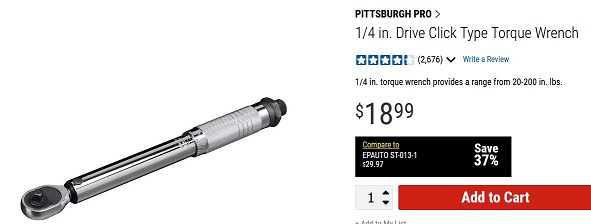

@Rocket Man Do you think I should go over it with my foot pound torque wrench set to the lowest setting or should I get a proper inch pound torque wrench?

Harbor Freight sells an inch pound one for cheap. I don’t know of any foot pound ones that are accurate at 8-9 ft lbs.

Sometimes with low foot pounds you can convert to inch pounds I have done that with motorcycle fasteners. https://www.theunitconverter.com/foot-pound-to-inch-pound-conversion/8-foot-pound-to-inch-pound.html
Yeah 12 inch lbs=1 ft lb so it’s not hard. The specs on my oil pan are 108 in lbs, pretty sure his are around there. But he only had a torque wrench that went down to about 12-15 and he used that, set on its lowest setting so like I stated in my earlier post, that’s 144-180 in lbs or are we missing something?
