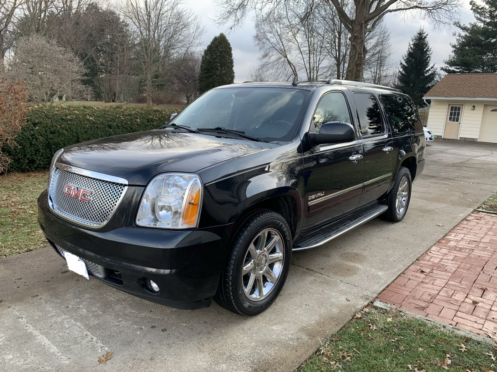

I am new here and the new owner of this 2013 Yukon XL Denali with 250k miles.
I was (and still am) very skeptical on the mileage, but after putting a hundred or so miles of test driving on I decided to pull the trigger. Very stable at 75mph. Oil pressure looks good.

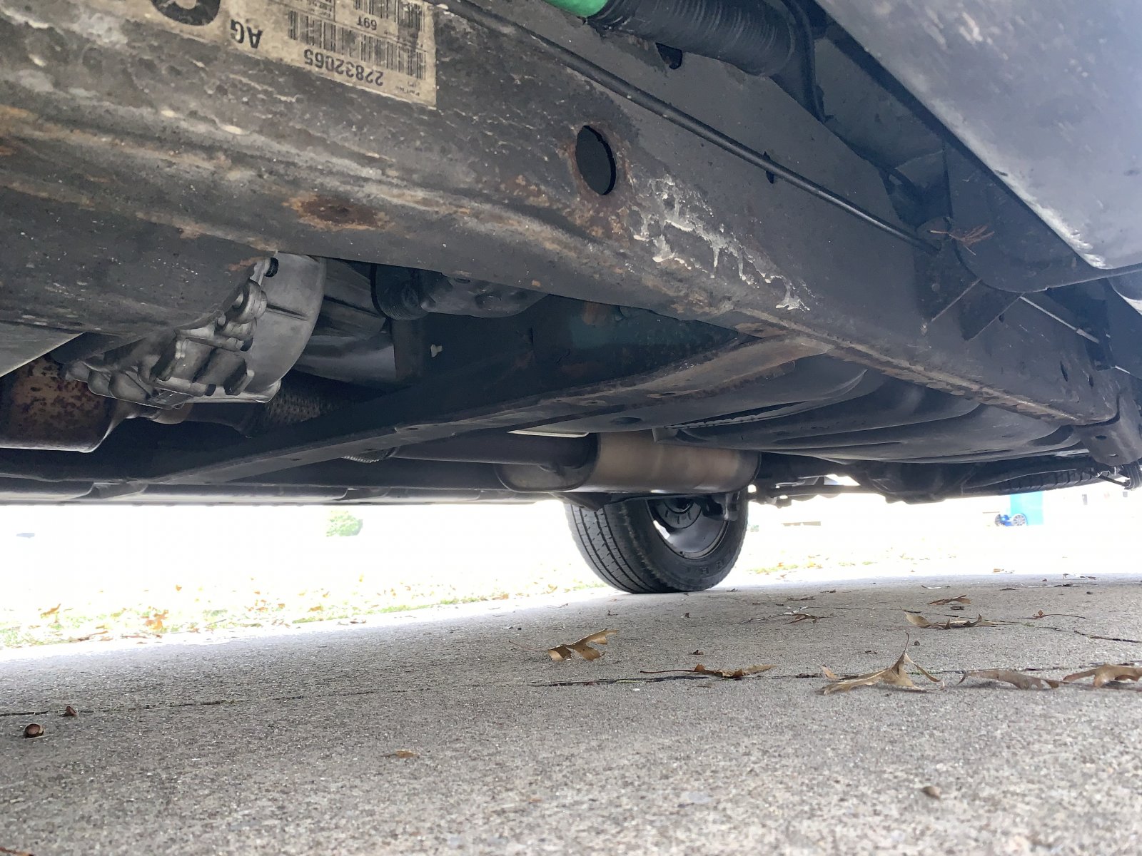

I went back and forth between buying one with 125k miles for $6-10k more, but the ones I looked at were in way worse shape rust wise. While the underside may not look completely perfect, for Ohio its as good as we get.

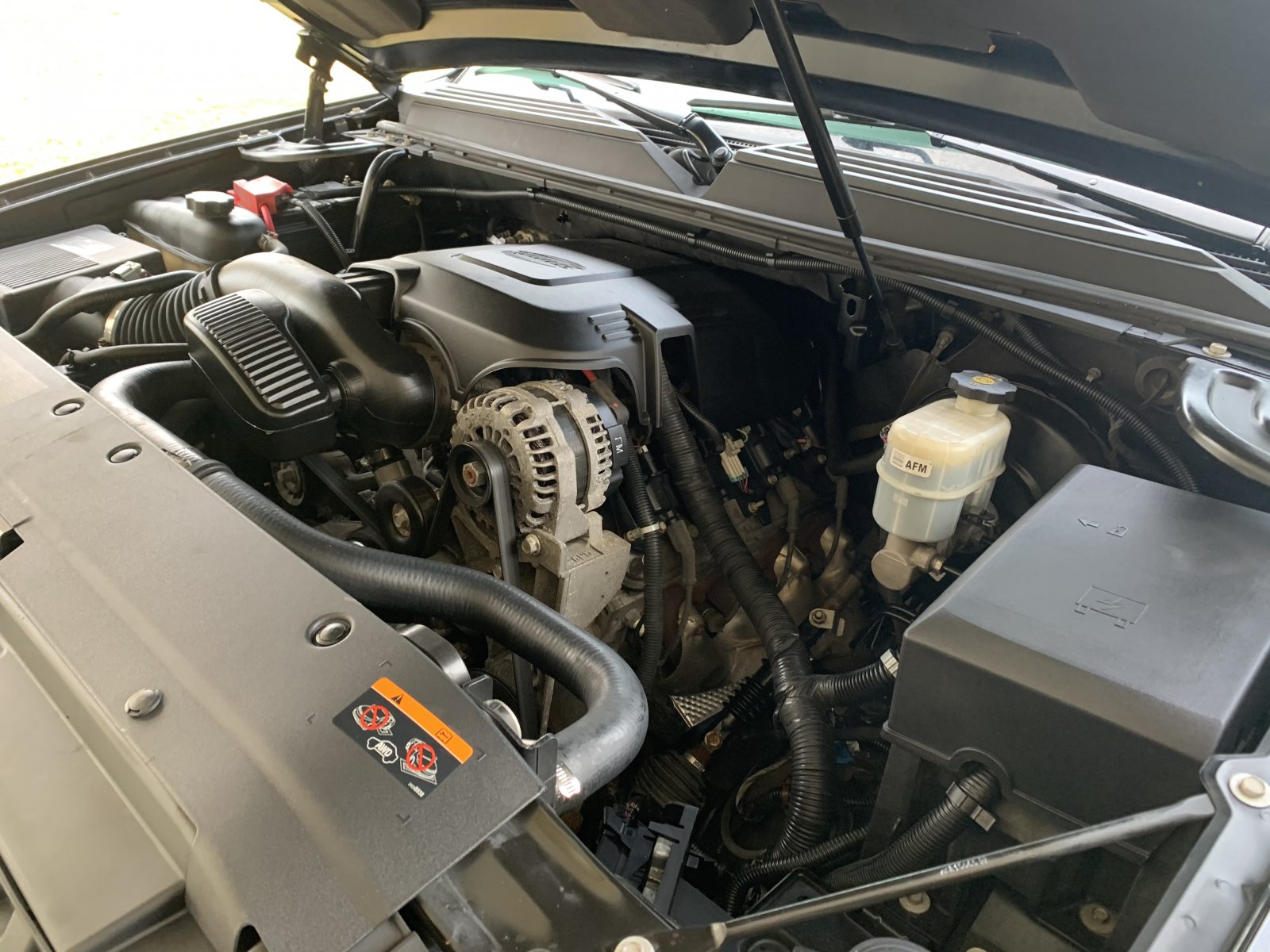

Hopefully it is a fairly reliable vehicle. I obviously am aware that the transmission or something could fail at any time, but it seems to shift well. The last flush was 120k miles ago, I am on the fence of doing a flush or just dropping the pan and replacing.
Power Steering fluid looks a little rough, I plan to change that. I know a pump could be necessary.

Looks to be in very good condition. Glad you got a 1 owner with all service records.

Welcome to the forum from Oregon. For a round trip plane ticket you could have flown to a state out of the rust belt and gotten one with no rust. But I do have to say that the one you got looks very nice. That 250k must have been lots of highway miles.

Looks great and all that highway mileage is like 25K in city mileage. Keep ALL the fluids clean and send out oil samples of the engine and transmission to Blackstone Labs for analysis.
Has the truck had any major repairs? Looking at the inside of that rear tire, you might need an alignment or the tie rods and or ball joints replaced.

Good catch on the tire James. If that was rotated from the front it does show inner wear and could be related to exactly what you said.

Happy New Year! No major repairs recorded. Just sway bar links at 115k.
I think you are correct, when i shake the front left wheel I can feel some play. I am assuming it is a ball joint. I am going to look into that.

welcome, looks good, it takes about 1 gallon of power steering fluid to get it all freshened up, jack up the front so the wheels are off the ground, pump out what you can then fill it with fresh, start it up and rotate the wheels fully a few times, shut it off pump out what you can re-fill with fresh, repeat until you have gone thru 1 gallon of fresh fluid and you should be good to go. If you replace the tires on the Denali be sure to do all 4 tires at the same time the awd drive system has to have all 4 tires within 2/32's of each other. I would flush the brake fluid also and the transfer case and diff's if the there are no records of them being done. A little preventative tlc can get you a ways down the road still hopefully without any major repairs.
