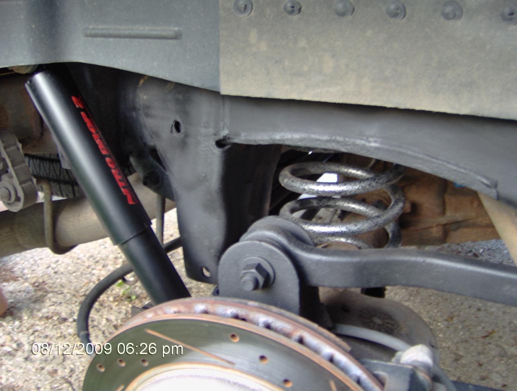

I would like to thank DJM for the GREAT deal I got on the Belltech 2 Drop shocks! They ride great and brought the back down the 1"-2" I was looking for! It is finally LEVEL!!! The free travel mod was super easy and well worth the effort! Thanks again to DJM!!! I hope these pics load!

no prob liek i said cheapest price for djm or belltech thats what im here to give you guys. Truck looks good now lets work on the front lol
i see you have the djm rear spring :)

They removed it from the djm website, essentially you'll remove the large factory bumpstop and surrounding sheetmetal for a lower profile stop and gain a few inches of travel. I still haven't done mine because of my helper bags but it will dramatically increase ride quality if you're running a 4-5" spring and no helper bag. Plasma cutter makes short work of the bracket.
