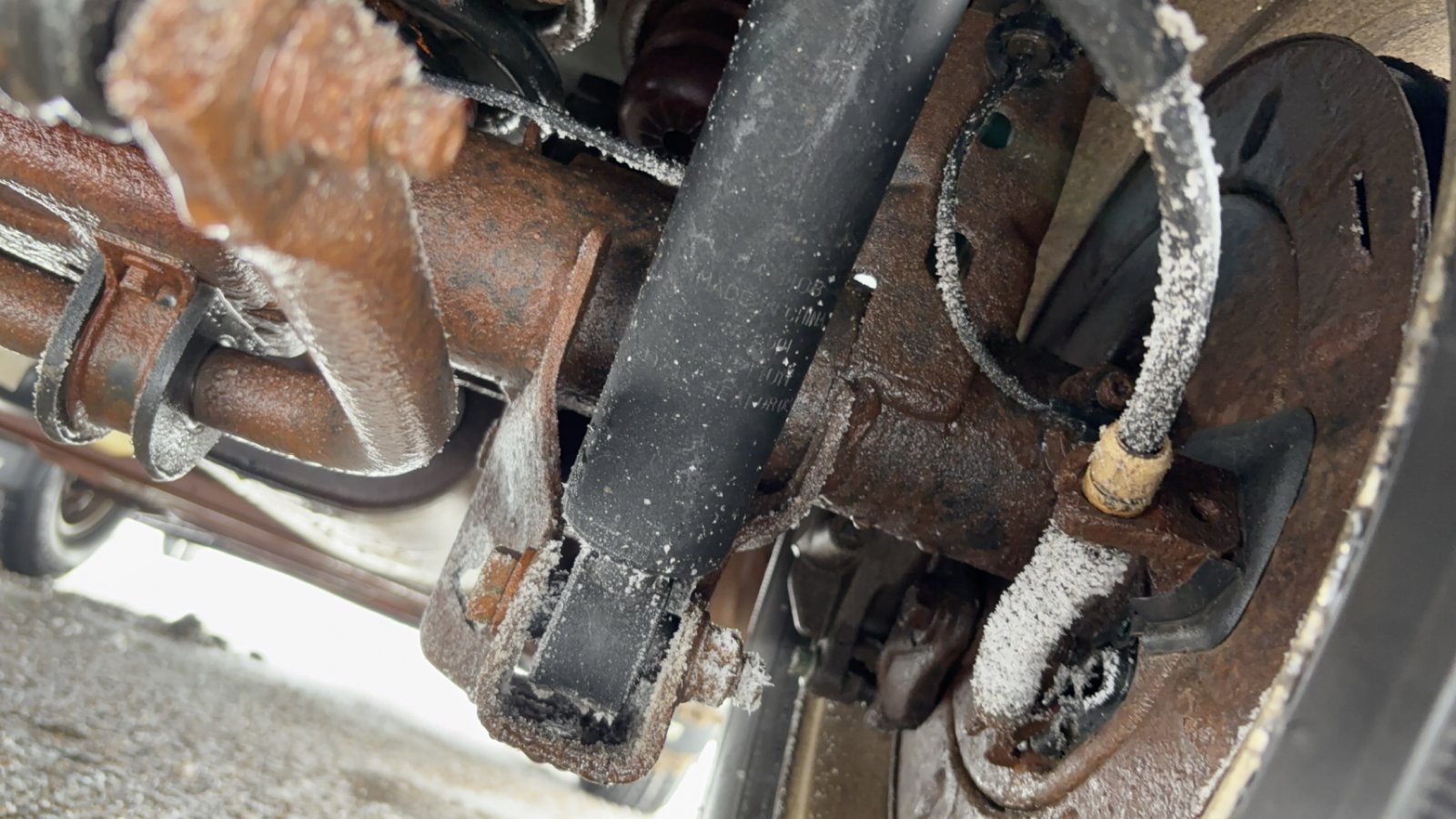

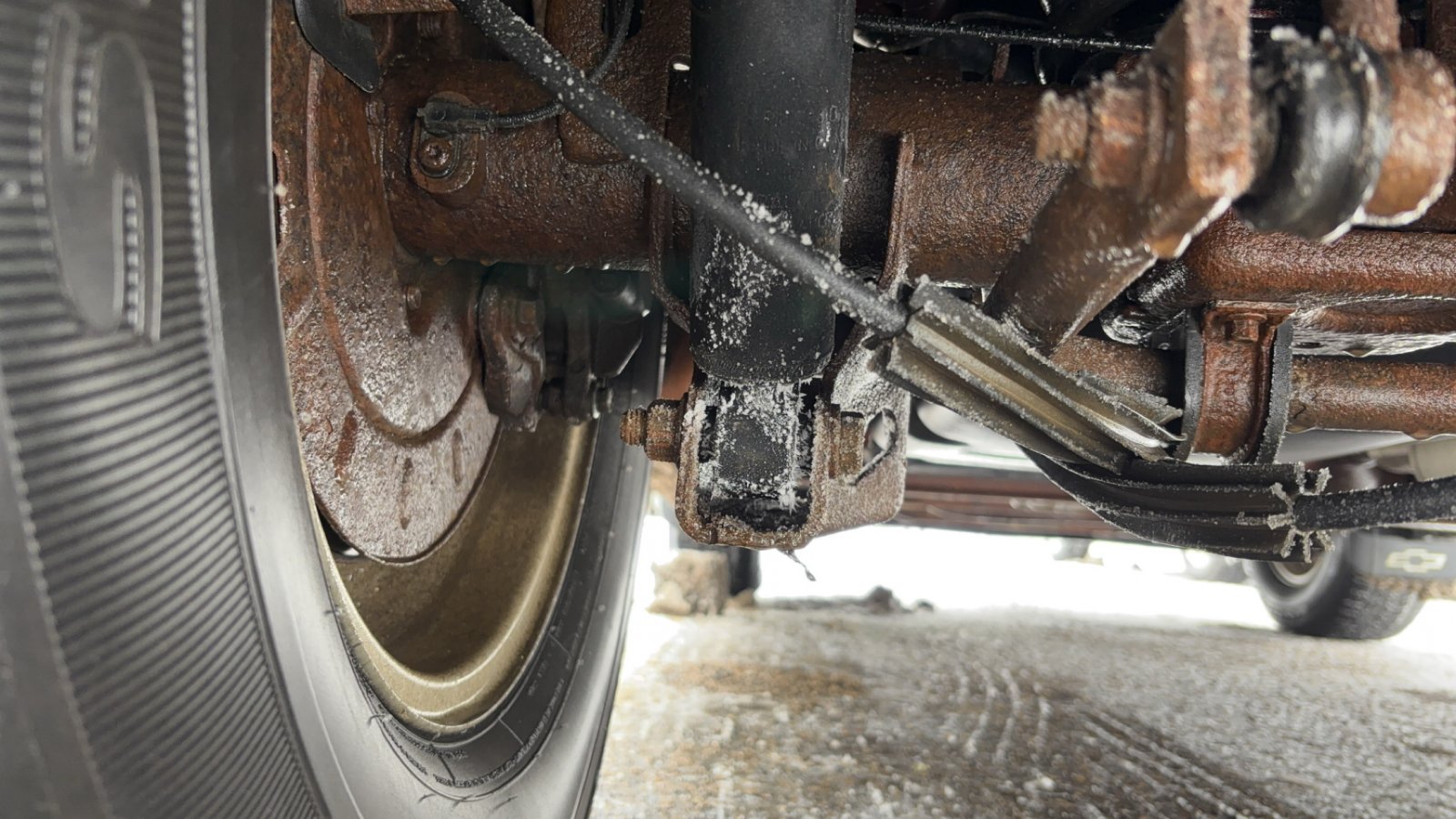

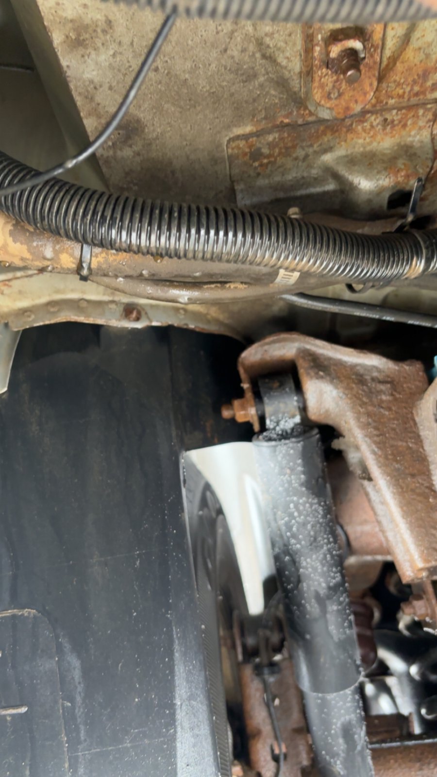

The only thing I see from your pic is that something has dripped on the metal or plastic cover shell at the top of the shock. I don't see evidence that the shock itself it leaking.
Do a bounce test on the suspension. Jump (or push) down on the rear bumper and see if it's hard to do or if the rebound is bouncy.

It’s hard to do. But still it’s a very bumpy ride.

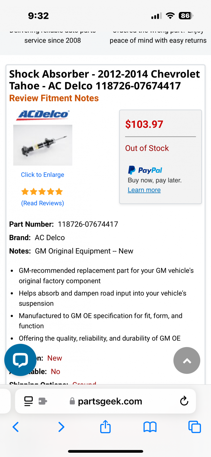

I ended up going ac delco for new ones.
