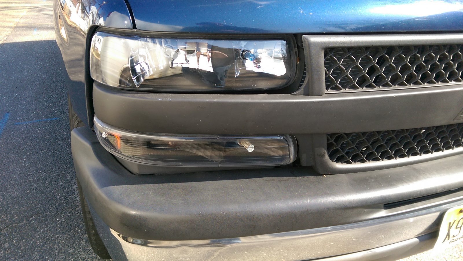

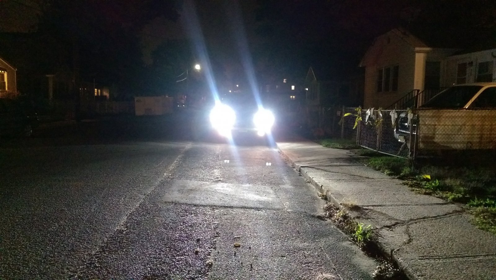

I have something similar to those headlights, from Spec D.IMAG1725_418533484238620.jpg 20180228_175310.jpg
I have leds in them. I like them. IMAG0721_416459950547171.jpg IMAG0717_416460546914984.jpg I've had them for 4 yrs. All I did was run a bead of silicone around the inner edge, put some dialectic grease on the bulb gasket, and I swapped the oem headlight brackets on it. Good to go, and they haven't fogged yet and they don't vibrate.

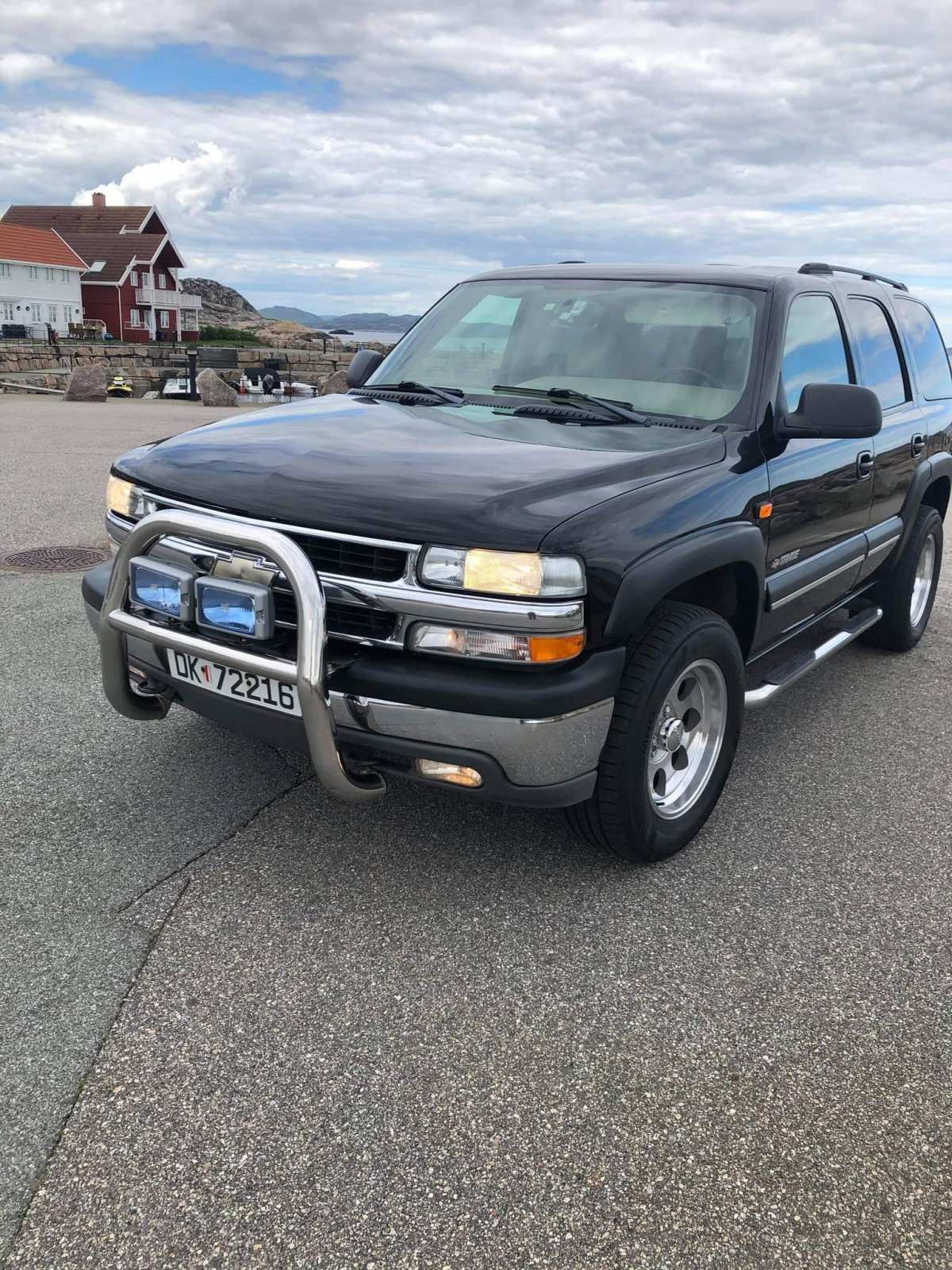

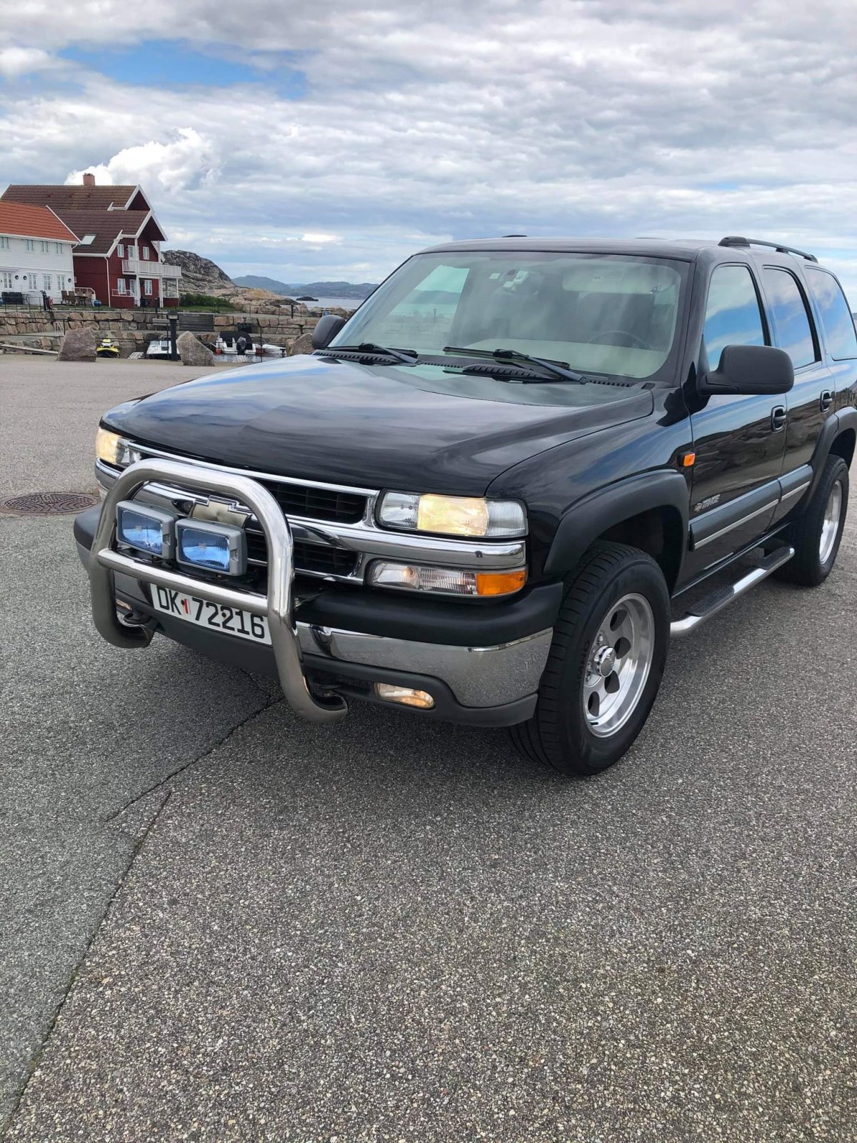

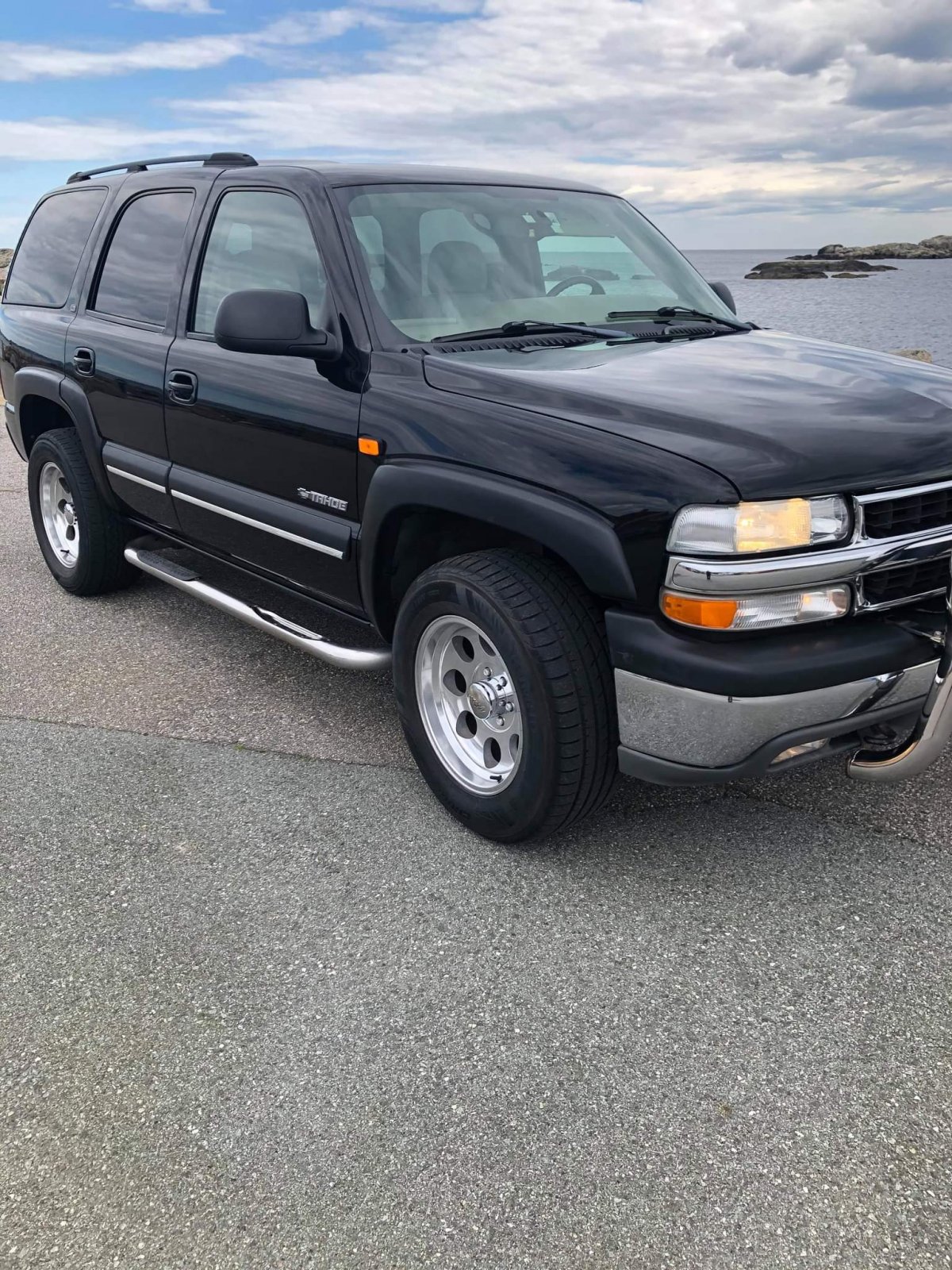

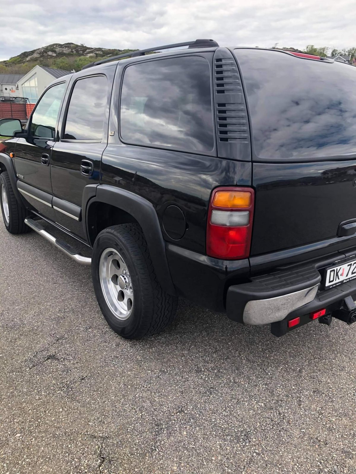

Here are some pictures of my Hoe. It's a pretty much stock LT with around 230.000 kilometeres (around 142.000 miles) I got it for $15.000 wich is cheap in my country. (Norway) I'm planning on removing the bull bar including the extra high beams, and painting front and back bumpers including the grill black. I want it to be blacked out, but still look a bit OEM.

She looks great so does the back ground.This previous owner wanted to be seen looks like.Those side lights probably have a hole in the fender if their lights now.You might be able to pop the cover off and put some cheap black tint over them-never seen that before.I would take off the red reflectors on the hitch also.Painting chrome is a ***** if not done right.Check on junk yard or getting a rear bumper thats painted or primed already to paint.Good luck and get your check book ready welcome to the TYF.
