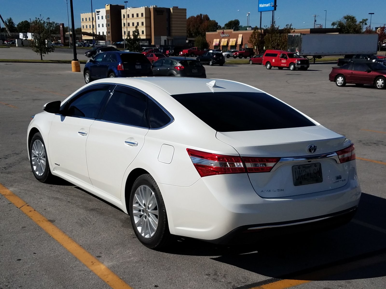

20171019_165945.jpg 20171019_165956.jpg 20171019_170035.jpg 20171019_170903.jpg
couple of the tint, inside, inside tint contrast of 35% to 70%, and a darker photo that might show the windshield better. 20171019_181148.jpg
she's a beaut clark! a beaut!
