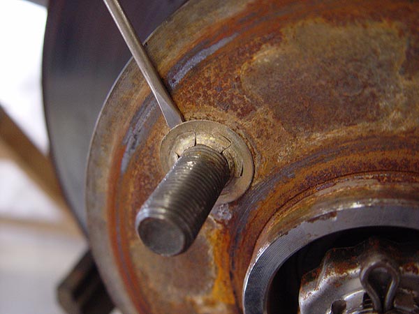

At this point you also need to make sure the wheels are not damaged where the lug nuts seat. The shape could now be damaged and the hole hogged out some.
^^^ This. And/or the stud threads damaged.

See what happens when you get old. I was also going to mention the possible stud/thread damage to look for and half way thru my post I must have forgot. Thanks for covering me.
