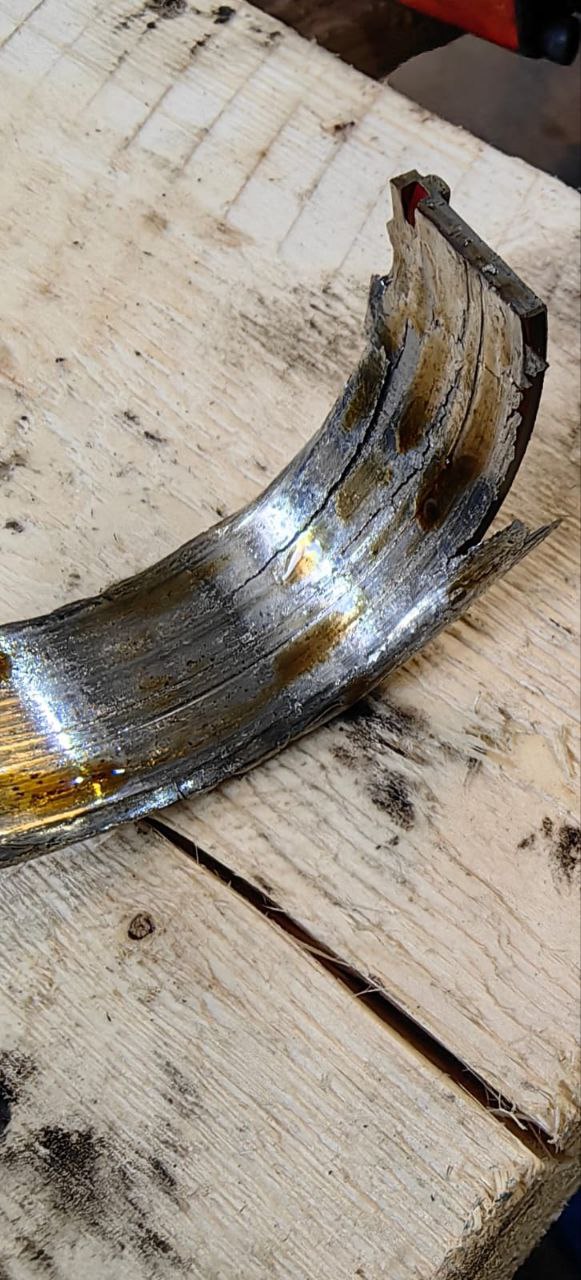

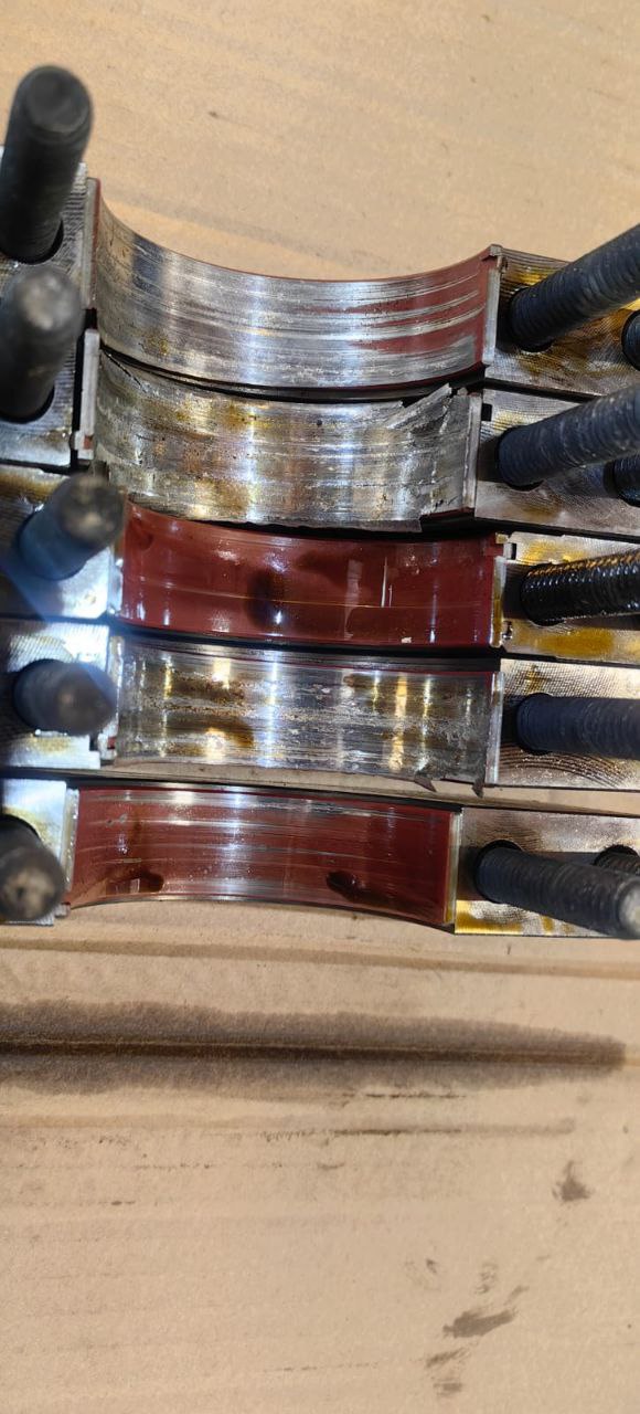

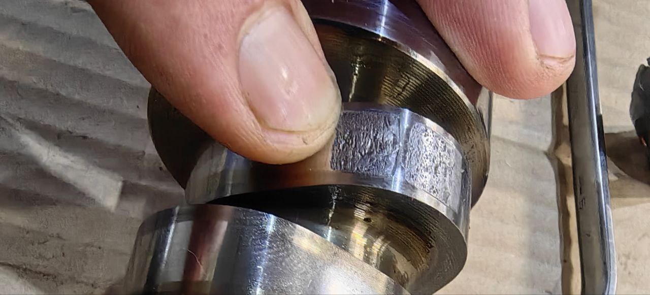

blanchard7684
Senior Member
Dec 23, 2024
190
79
Interesting YouTube video, while this is a 2017 6.2l with over 100k miles, the engine is VERY clean and it appears only 1 bearing had any issues. The main bearing cap was not removed in the video and it is unclear if any of the cam bearings started to flake or fail. From the metal in the oil pan, it looks like more than just from the one rod bearing.
If I was rebuilding or reworking new engines, I would likely go with King Engine Bearings. Even if buying a new motor, I would likely at least replace the main and rod bearings.
I wonder if the same style of bearings were used in the 1999-2006 6.0l engines. I have one that is over 275k miles and still going without lifter or bearing issues.
That is a gnarly looking bearing. Doesn’t look like debris or oil starvation. That actually looks like a defect bearing delaminating
