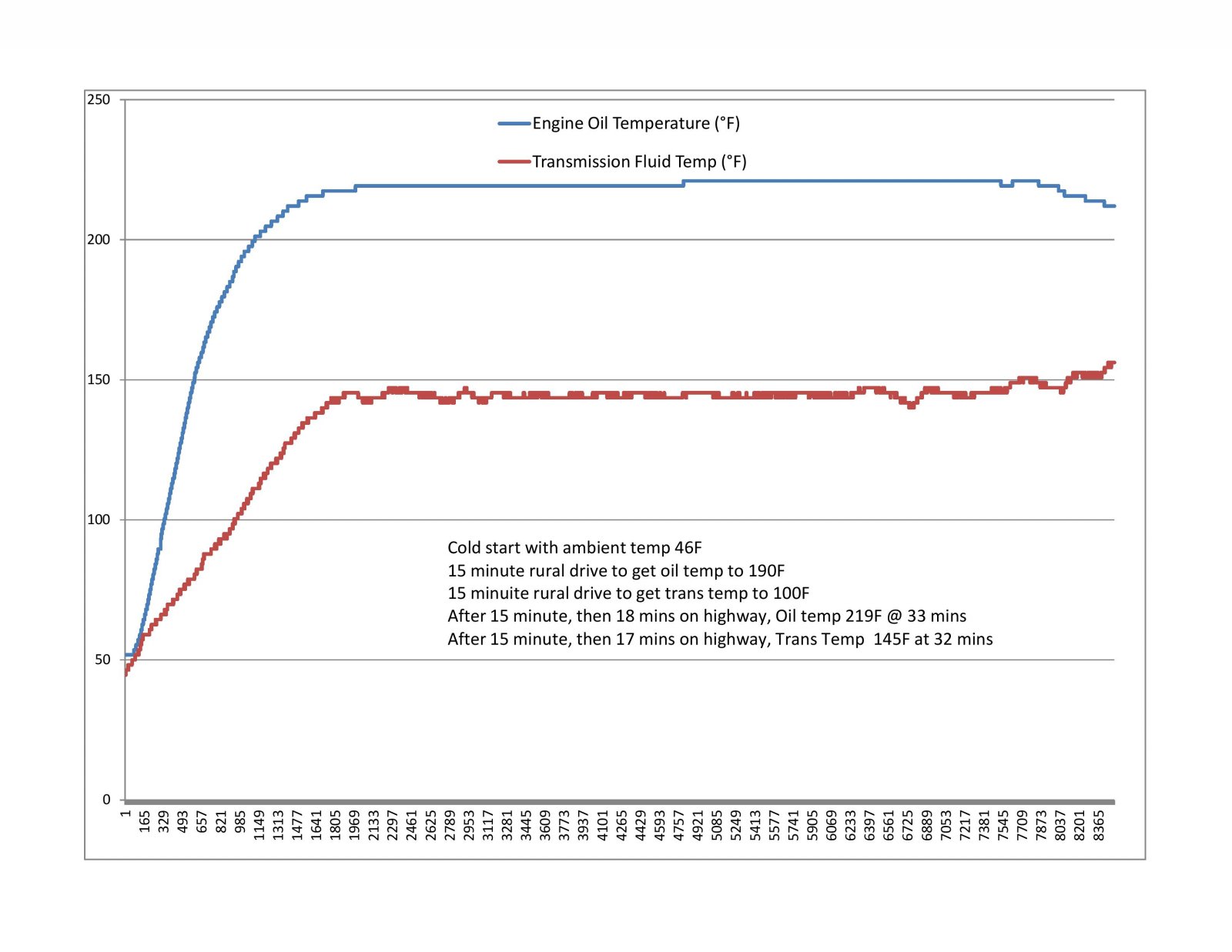

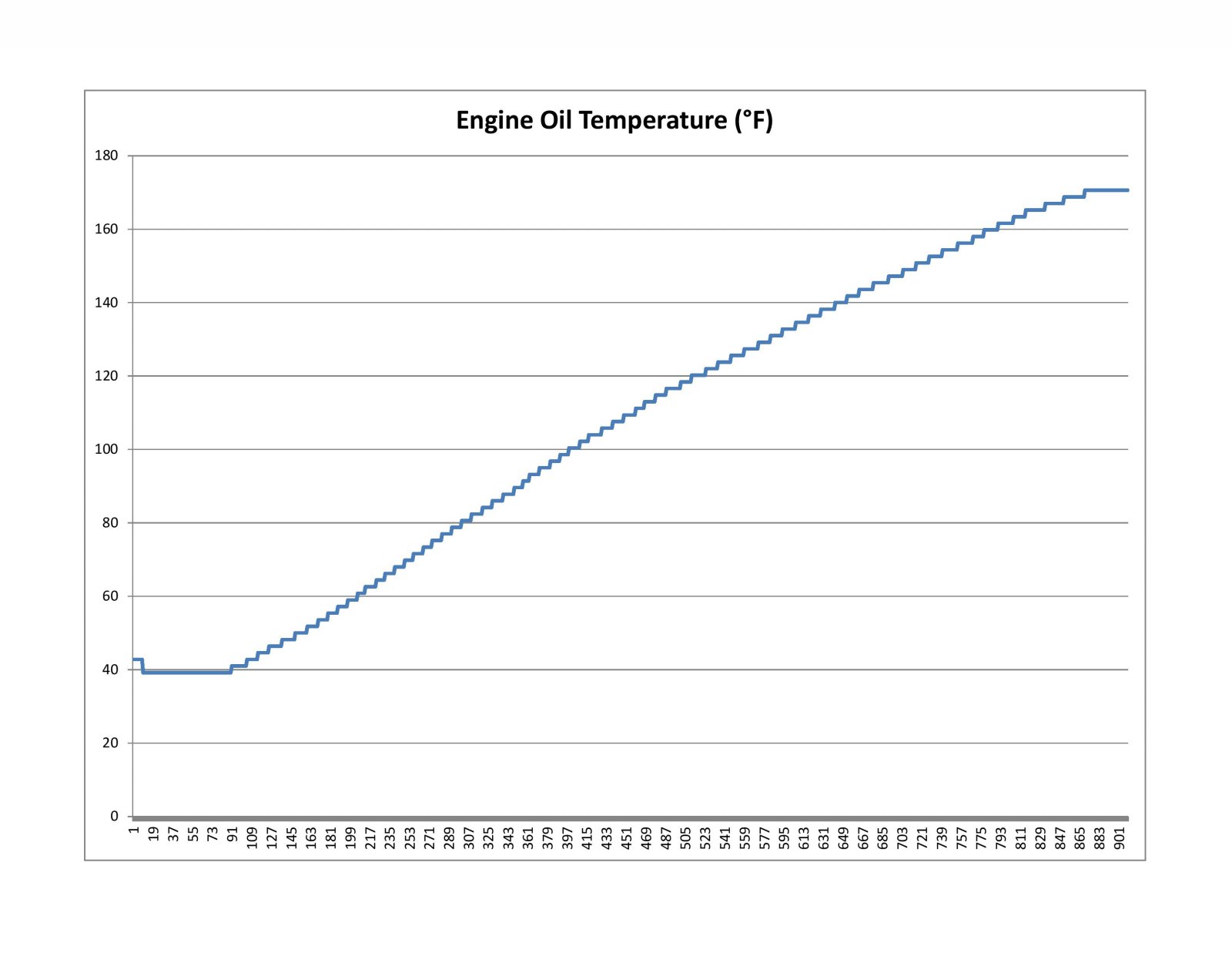

8 mile, 15 minute drive. Ambient temp was 39F, start up oil temp was 43F probably due to some laten heat in the engine block because the outside temp had dropped. After 8 miles/15 minutes the engine oil had only reached 170F. So maybe some of what I have been saying about short drives and fuel contamination and not cooking off fuel out of the oil may make some sense?
I will have some other decent data in the next few days. Keep in mind the engine coolant temperature typically should hit 100F in the first mile. Guestimating it looks like the engine oil temp did not hit 100F until about mile 3 or 3.5?
2nd graph is a comparing a 15 minute cold start idle vs a slightly longer cold start drive
3rd graph is a 36F cold start 32 minute drive which show the engine coolant temperatue took 16 minutes to hit 200F and the oil temperature takes 29 minutes for the oil temp to hit 200F.
Finally was able to see oil temp hit 223F after about 2 hours of highway driving on a 64F day.
Bottom graph, cold start @46F Ambient, 15 minute rural drive, then the rest is highway. Engine oil took 33 minutes to fully warm up and stabilize after cold start and 15 minute rural drive. 15 minute rural drive the engine oil reached 190F, really not warm enough to fully start cooking off fuel and water vapor.
Oil Temp From Cold Start 15 minutes 8 miles.jpgCold Start vs Cold Start Drive.jpgOil and Coolant Temp 36F Drive.jpgOBD Screenshot.pngEngine and Transmission Temp.jpg

So 23 minutes for oil to reach a fairly normal operating temp? (starting from 40 deg).

23 mnutes, PLUS time not Logged idling in a Drive Thru! The oil went from 170F to 185F during this time.
Maybe my truck needs a new thermostat?? NOT!
