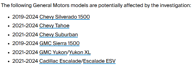

The L87 was used in the 2019 and newer Silverado & Sierra with the 10lL80. Are the 19 & 20s from the pickups having the same issues or is it 21 and newer? Did the 19 & 20 SUVs have the L86 or L87?
The NHTSA investigation applies to the following:
It's the L87 they are investigating - which as far as I know has only ever been coupled with the 10L80. In the '19-'20 SUVs it was the L86 with the 10L80 and those are not affected by the investigation nor do I believe anyone has ever had a pre-L87 experience low mileage bearing failure.

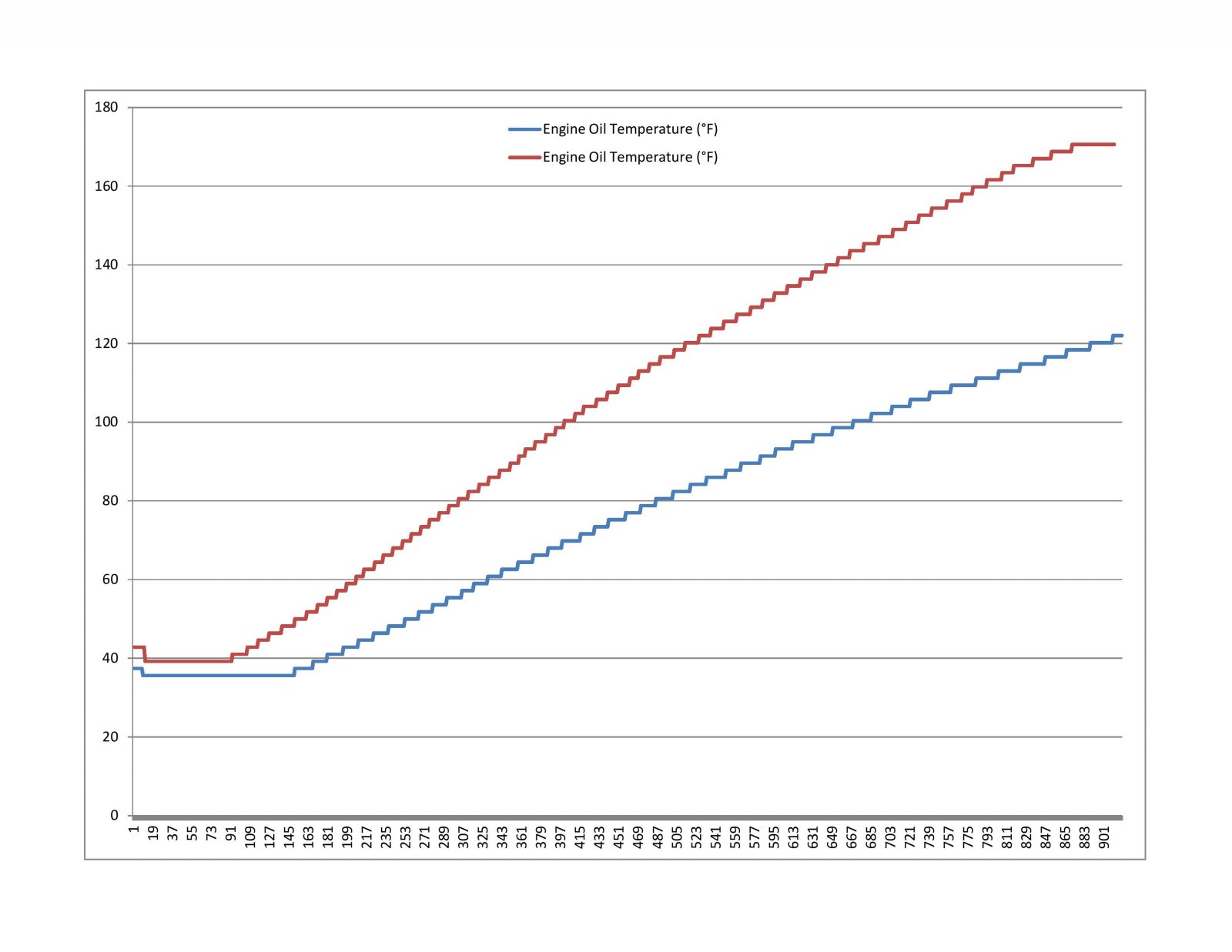

The issue is not just a problem with the 6.2l, but more pronouced with all DI gasoline engines for a variety of reasons. Clearly warming up in the Winter is a bigger issue with fuel contamination than during the Summer, but allowing the engine to idle to warm up will allow more fuel to get into the crankcase regardless of the ambient temperature.
The 6.2l in the full size trucks and SUVs's appears to be configured to operated at Low RPM and under VERY High Torque loads on a consistent basis which puts tremendous pressure specifically on the rod bearings. The rod bearings are dead last in the oil flow path in these engines. Add to this LSPI which is aggrevated by fuel in the oil and the fact that the speced oil is probably borderline when fresh and likely inadequate once fuel is in the mix and the oil viscosity drops. Load the vehicles up and/or put a trailer on the back, things will not turn out well. Once fuel starts to dilute the oil, oil consumption typically increases, so the risk to the engine being run low on oil is much higher.
Fuel gets into the crankcase past the piston rings and moreso when the engine and engine oil is cold. Cold cylinder walls allow fuel to condense a liquid fuel really does not burn, this just adds to the visous circle of fuel dilution of the oil. The longer the engine takes to warm up, the longer you have conditions for excessive fuel to end up in the crankcase.
Still trying to gather data, but below is a graph of the engine oil temperature on the same 6.2l for the same basic time period. Starting ambient temperature is 5F different.
The blue curve is cold start and idling for 15 minutes.
The red curve is cold start with idling for 30 seconds then driving the vehicle for 15 minutes.
A few notes to consider:
1. The difference in ambient temperature between the 2 starts was 5F, so there is a slight offset in the curves.
2. The dip in the start of the graphs is the laten heat in the engine because the outside air temp was slightly lower.
3. When driving the oil temp started to increase at 93 seconds, when idling the oil temp started to increase at 151 seconds.
4. At the 7 minute mark when driving the engine oil was 104F, the idle oil temp corrected for the difference in initial temperature was 77F.
5. At the 15 minute mark when driving the engine oil was 171F, the idle oil temperature corrected for the difference in initial temperature was 125F
Even after a 15 minute drive the oil was not fully warmed up. So understand that shorter drives in the colder months will take more of a toll on the engine oil with fuel contamination.
