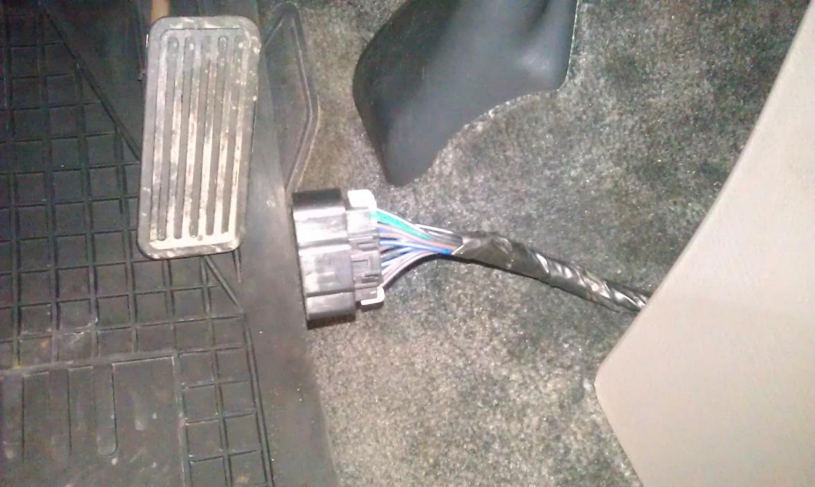

The center console is not the factory one, so I don't know if the truck was ever delivered with rear audio controls. There is a harness and connector under there, but the connector doesn't look like the correct one for rear audio...?
See picture 1 of the connector next to the accelerator pedal.

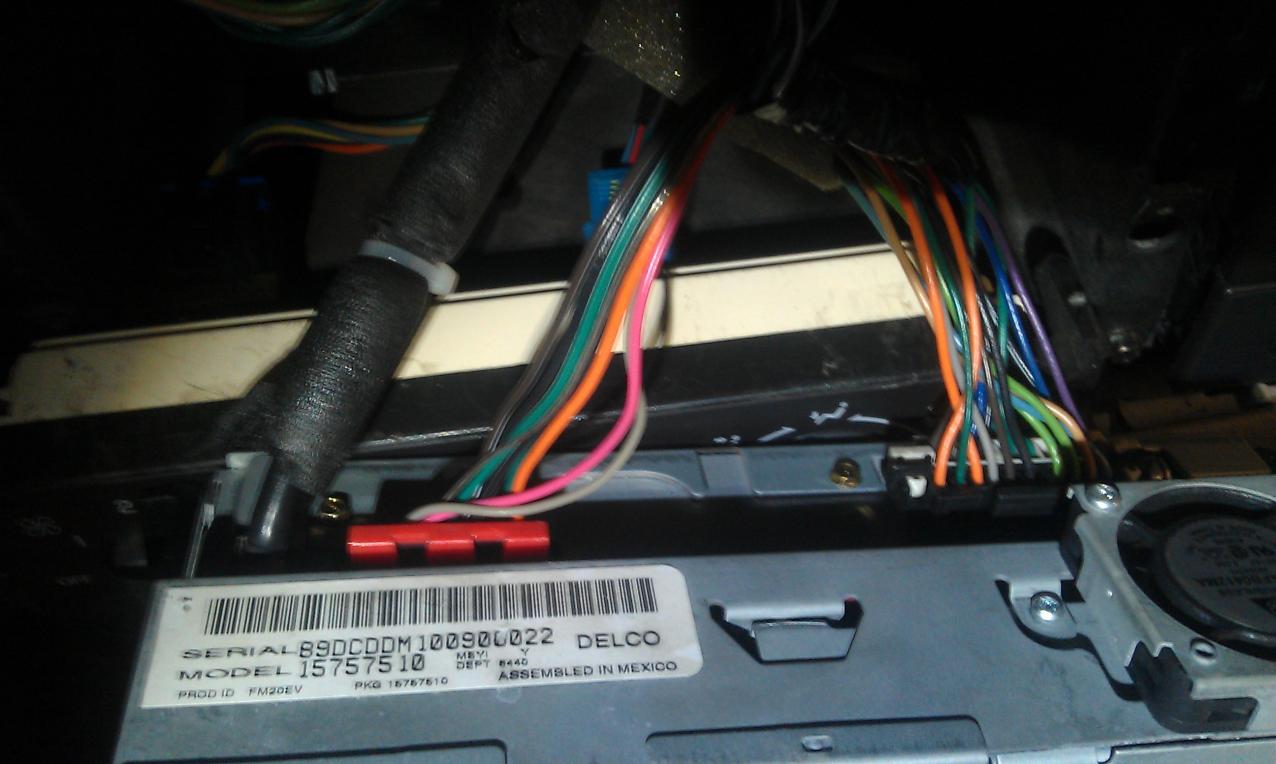

On the back of the factory unit I have two harnesses plugged in.
Probably main harness and cd-player. See picture 2.

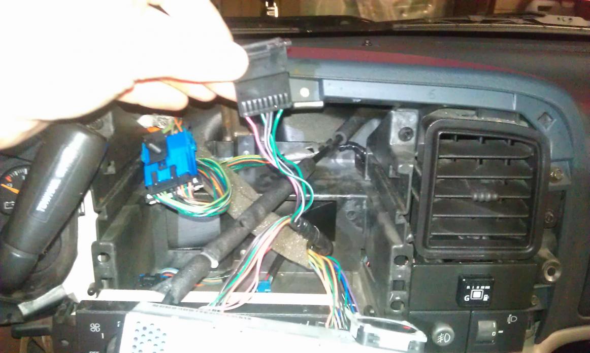

I also have a loose connector that I don't know what is or where should be..
It's a female connector, and it fits right on to the cd-player connector.
If I unplug the cd-player connector and plug it in the loose one there is no change. See picture 3.
What are these connectors?

The signal goes through the rear audio controls. The rear door speakers and d pillar tweeters are terrible.
