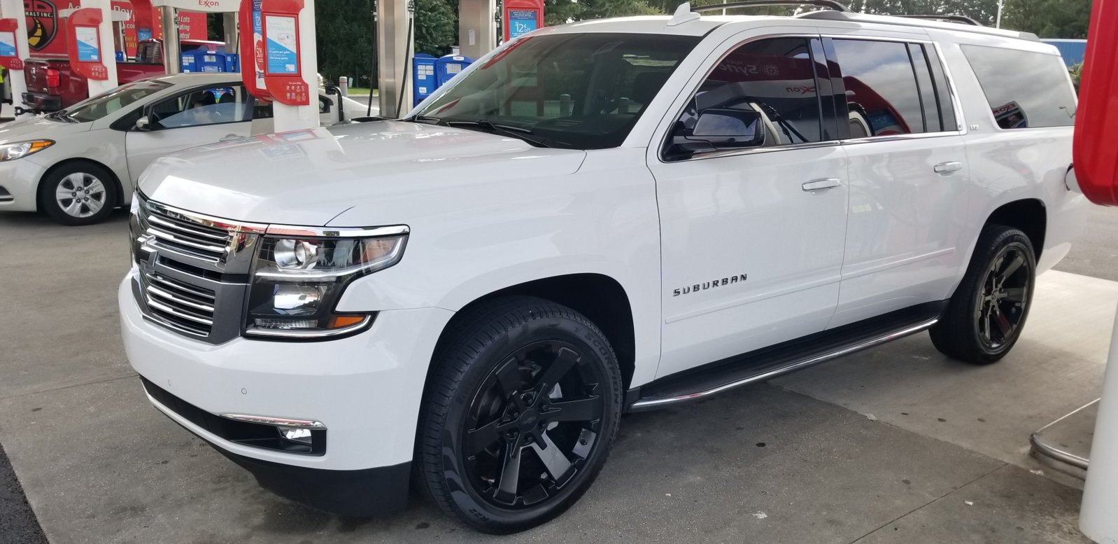

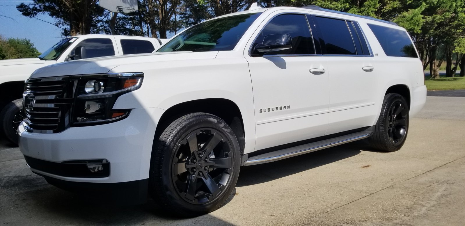

What are your measurements from ground to fender up front and rear?
Front driver is 35 3/4", front pass 35 7/8", both sides rear are 36 1/8" after settling this week.
Tires are 285/45r22

And I'm 35.25 in the rear

What tires do you have? I had the factory 18s up until 2 weeks ago and the front sat at 34 1/2. Jumping up to the 22" option raised the truck up over an inch but the wheel well gap is smaller and that's all I was concerned about. I really didn't want the thing slammed on the ground riding like a roller skate so for me this is perfect. Level, factory comfortable ride, and not a ton of wheel well gap.
