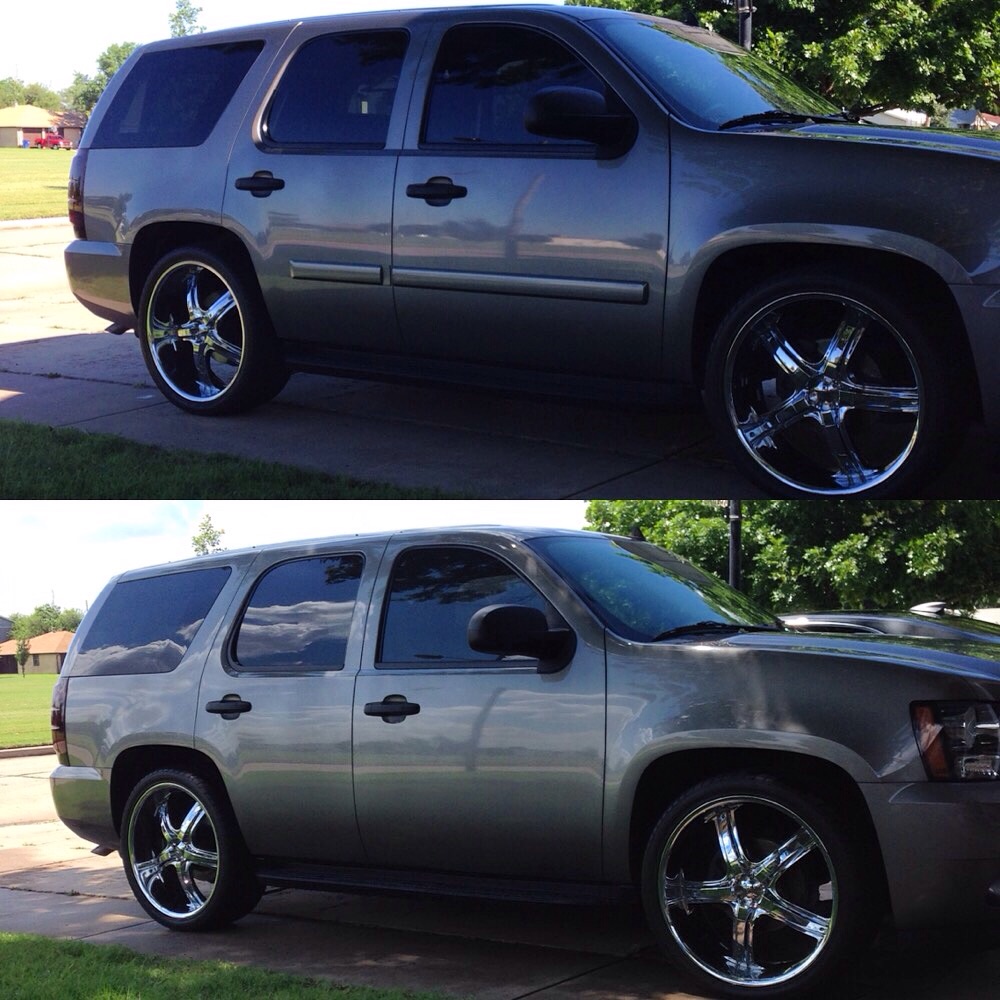

Just some updates on the drop. All measurements taken from same spot. Complements in drop for anyone wanting to know are ground force front and rear coils and DJM shock extenders. Adjustable Panhard will be going in soon as well
Stock height
Front
L:36.5"
R:36.75
Rear
L:37.75"
R:38"
Right after drop
Front
L:34.75"
R:35"
Rear
L:35.25"
R:35.5"
After driving around for a couple weeks
Front
L:34"
R:34"
Rear
L:34.75"
R:34.875"

This is the drop shown in your updated pics on the first post? Did you just swap out the springs in the front to get the 2" drop in the front? How is the ride?

Yes but those are pics right after the alignment so it hadn't settled much. although the kit was bought used so it probably didn't need much if any settling.
As far as ride quality to me feels like stock really. Not much change besides feeling like I have a little better control with the little lower stance
