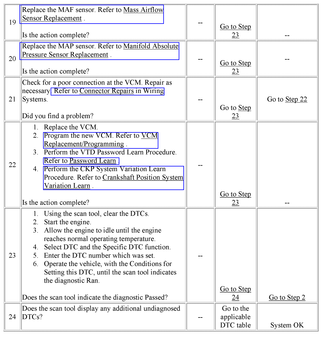

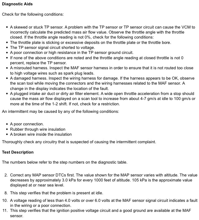

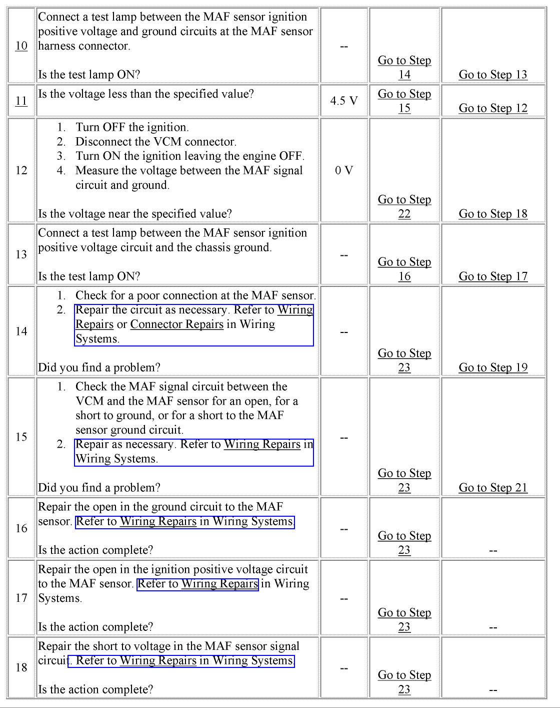

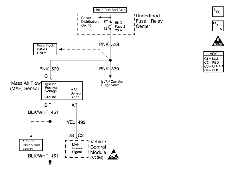

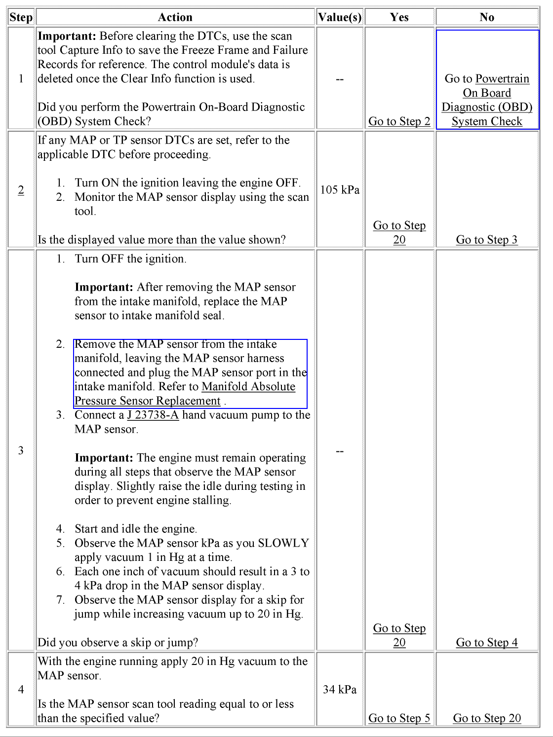

Here are the tables for P0101, hope it helps...

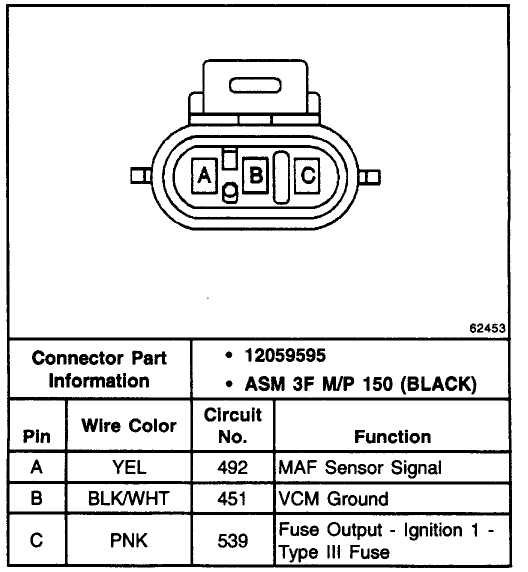

MAF connector:
