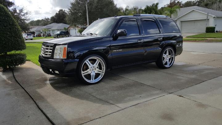

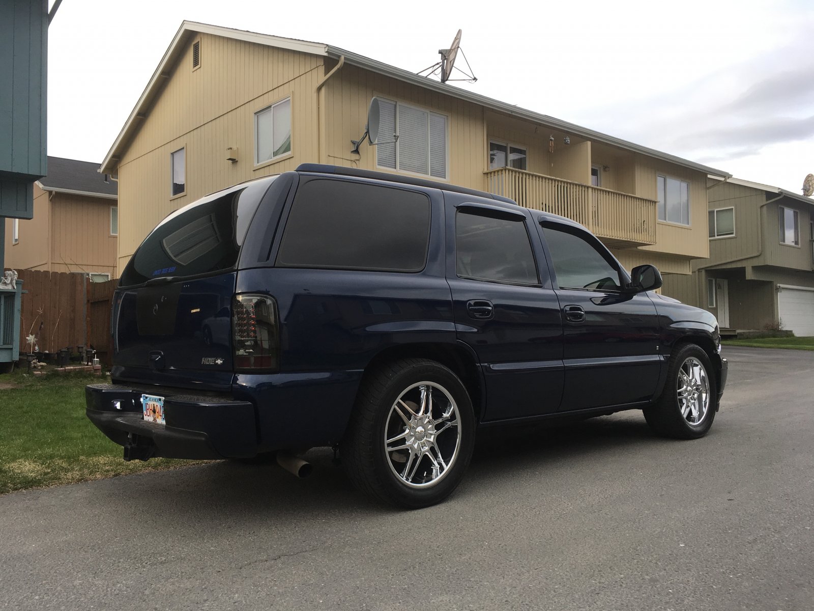

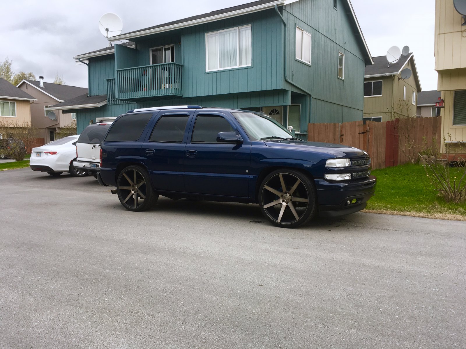

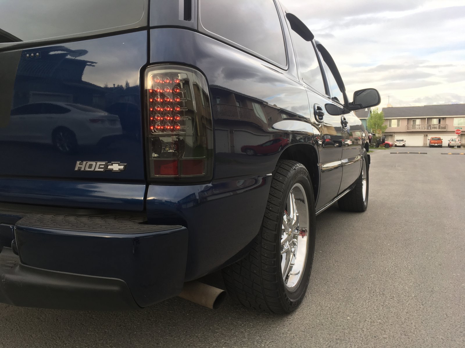

None! Not over any bumps or sharp turns. After drop I had 275-60-20" Goodyears and rubbed a little at front wheel well on bumps so went to tire measurement guide for 22" and 285-45-22 was an inch less in diameter than the Goodyears. Perfect!

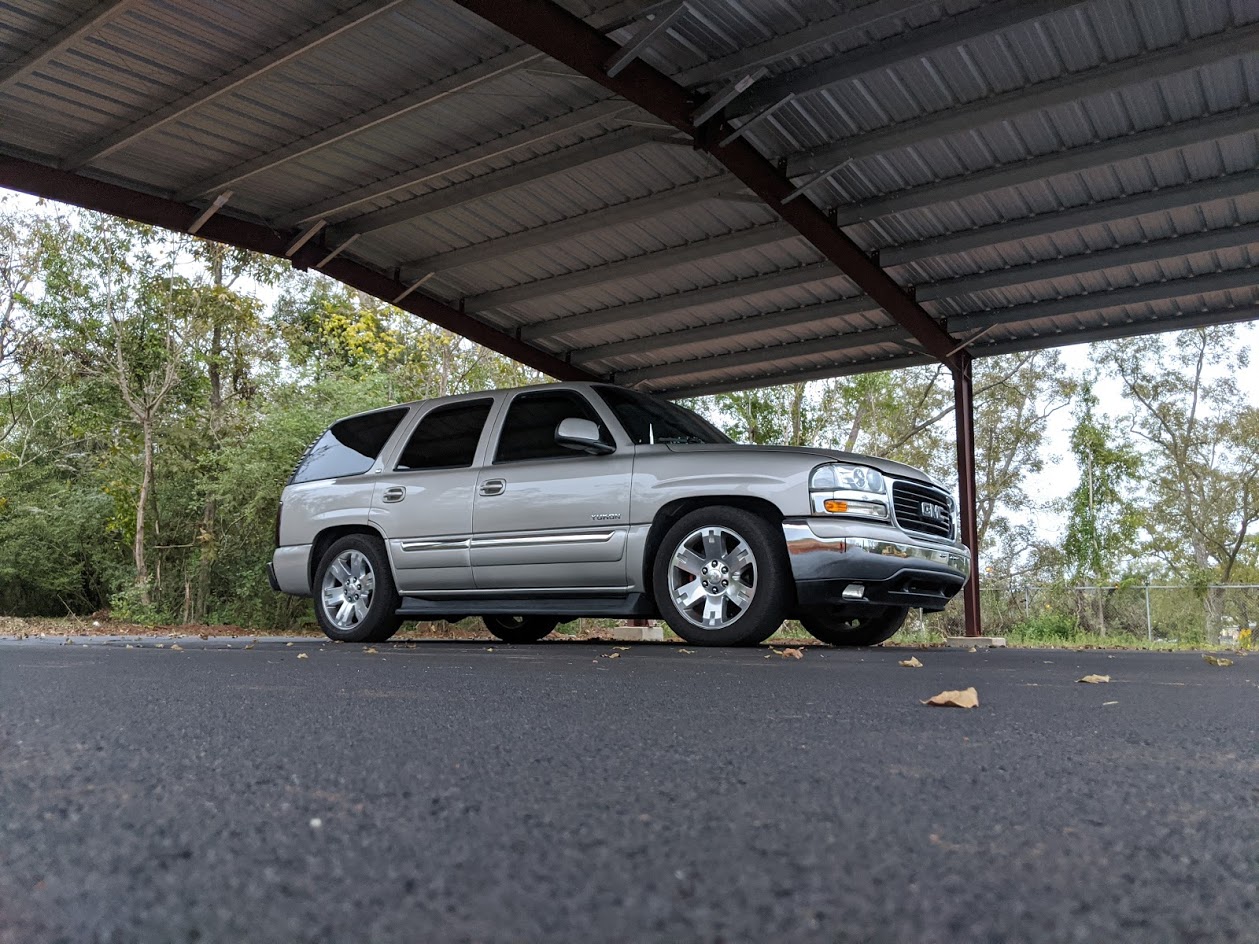

2005 PPV Tahoe(Texas DPS)
3-4 drop
Lca-Djm 3"
Uca-stock
Energy suspensions poly sway bar bushings/end links
Beltec ss shocks
Keys are what came with the PPV package(stock)
Just added 07+ 17's with 265/65/17 Tires
Beltec 3/4 rear springs didn't use spacer so 4" drop in rear.
Djm end links
Sick relocate brackets /stock shock
Airlift 1000 bags.
All the rest is stock.
31.5" front to fenderwell lip
32" rear
So far the lca's aren't that great for the drop and price.Truck has more bump steer now..Rear is alot softer than factory pedders springs.I want to upgrade rear components ..Rides great on yhe highway,just road walks now..

Looks good! You didn't happen to measure before you dropped, did you?
I've been curious about going the PPV/Z56 rear suspension, but don't know if it's even worth it.

I sure did,ill find it and post it..Ive got the rear springs if sell..It actually road WAY better than these belltecs

Lf=33.5
Rf=333/8
Rr= 34 3/4
Lr=35
I have the pedders springs id sell..It rode way better than these belltecs.Here's the measurements with the ppv factory height
