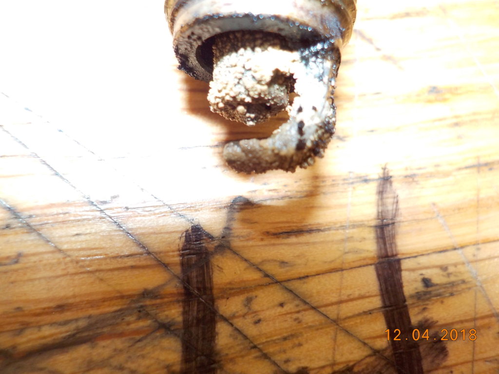

Another thing you might check when you get time are the spark plugs for oil fouling. Since you have that new valve cover and catch can, you likely won’t be adding much to that, but cleaning any oil/carbon fouling that was created by the oil ingestion might make her run even smoother.
Start with #7, that might be the worst of them.
