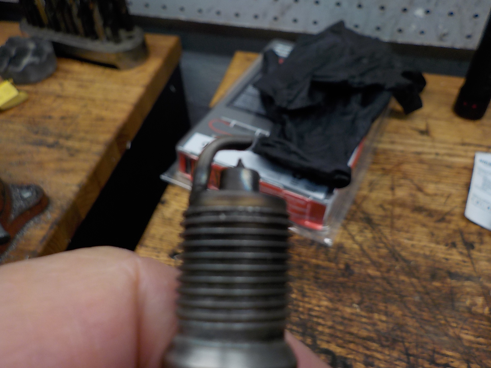

I was trying figure out if there were plug seals, from what I’m learning here, not a thing.
Some engines have rubber seals where the spark plug tube meets the valve cover. I thought this engine would have those to replace - I’m finding oil on the threads of the plugs.

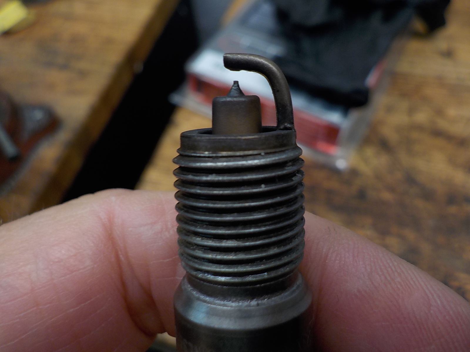

You probably don't have an ignition problem. How do I know? Checkout the thread I did: https://www.tahoeyukonforum.com/threads/sparkies-no-beno.108579/ As ugly as the plugs were, it ran perfect, and no codes.
My guess is you have a bad or clogged fuel injector.
Read this GM technical service bulletin (TSB) that applies to your tahoe:
https://f01.justanswer.com/ebrock63...il+Consumption,+MIL+ON,+Engine+Runs+Rough.pdf

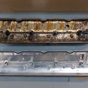

The updated driverside valve cover is a must.
Oil on the threads of spark plugs is a must because a dis-similar metals (steel plugs and aluminum heads.
There aren't spark plug to valve cover seals on GM V8s.

Top is the original (bad design) valve cover w/130k miles.
Bottom is new updated design.
