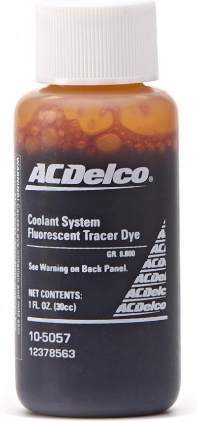

Going forward you might want to put a bottle of UV dye in the recovery tank so as to keep an eye on any small leaks that may develop. Not absolutely necessary but it wouldn't hurt for added piece of mind.
