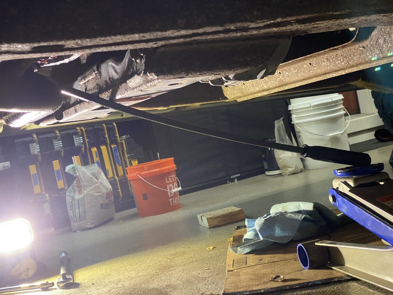

My ‘07 wasn’t too bad. Just needed to pry the exhaust out of the way..
And I sucked most of the fluid out prior to dropping the pan via the dipstick. Worked well!
