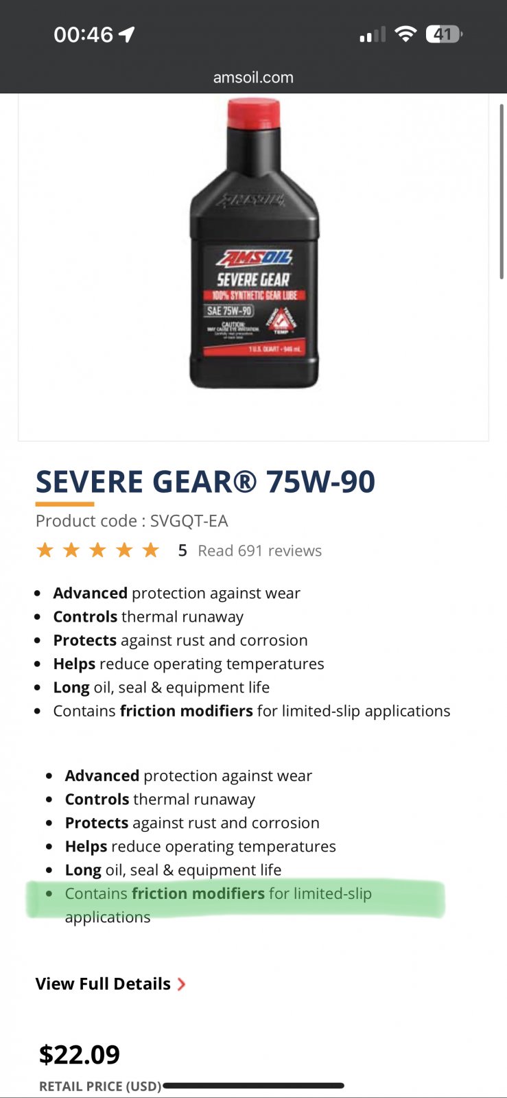

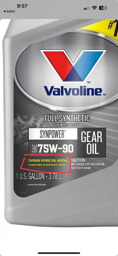

And to confirm, the G80 is a centrifugally activated mechanical locker, not a limited slip, so it does *not* use LSD additive.
This is what I understood as well. It's a locker, not as LSD.
But I know guys call the G80 anything but a locker: LSD, positraction, etc.
Probably the confusion is that G80 was also a rpo code for an actual LSD on other vehicles, such as tbe F body's
DaDenaliDude
DaDenaliDude
Aug 25, 2021
37
18
Might wanna read about the product you’re intending on using :happy160:
Well they pretty much all do. I was doing some research yesterday and the Valvoline brand does too. So I’m assuming it doesn’t matter. I wanted to use Amsoil or Valvoline only so I I’m just gonna use one of them with no additive because according to the bottles they already come with it.
