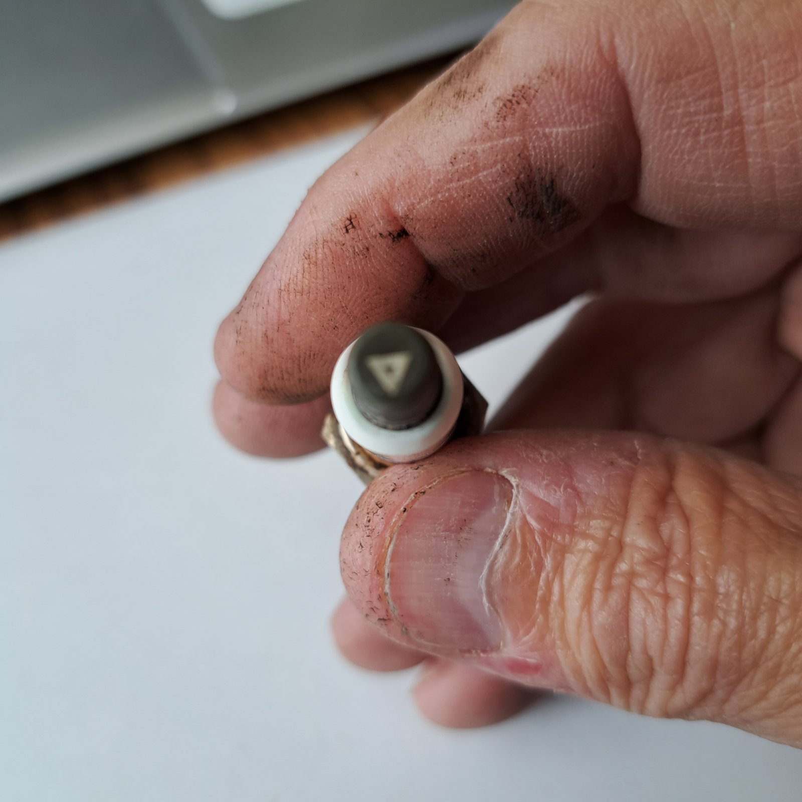

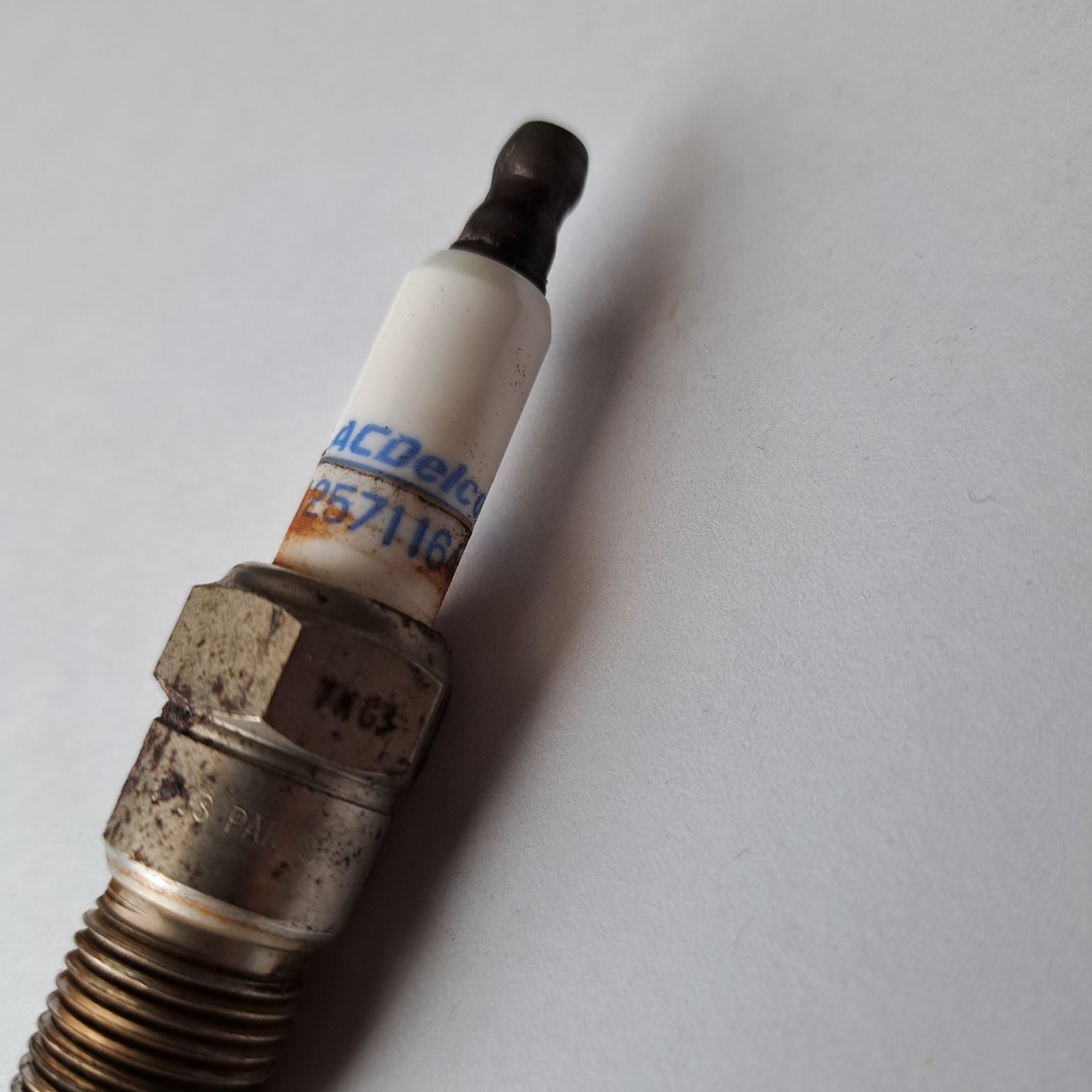

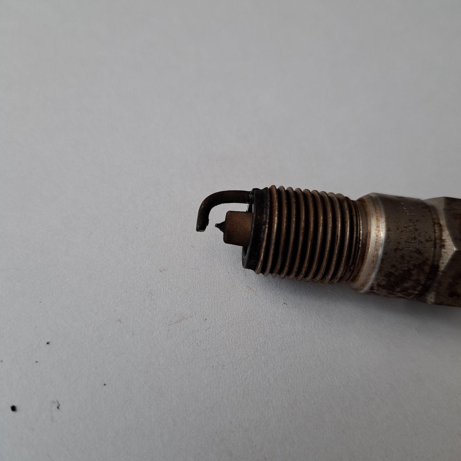

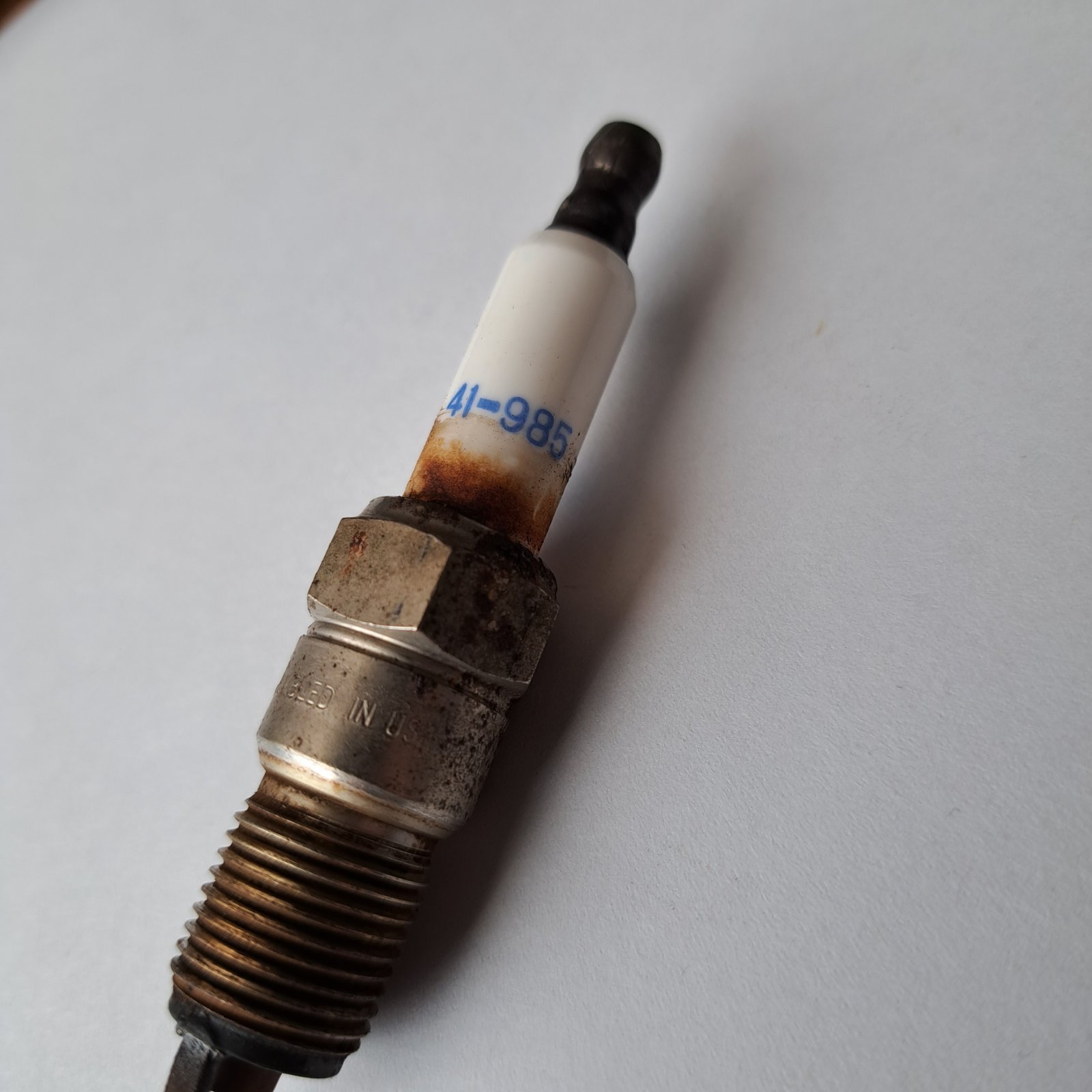

Ok, pulled #2 plug today and I see plugs stamped 41-985 and 12571164 and has the triangle stamp on the top of the plug. I used to think that the stamp on the top meant they were original plugs but now I am unsure. RA calls for 41-962 Double Platinum plugs. They do not show an iridium option. Also, if I do a search for 41-985 plugs, they do not come up at all on RA, Amazon, Genuine GM Parts, GM Parts Direct or Auto Zone. That tells me, I am assuming here, that the 41-985 is the OE plugs and the 41-962 is the updated and current double platinum plug. Does anyone here know for sure? Is the Iridium plug the 41-110?

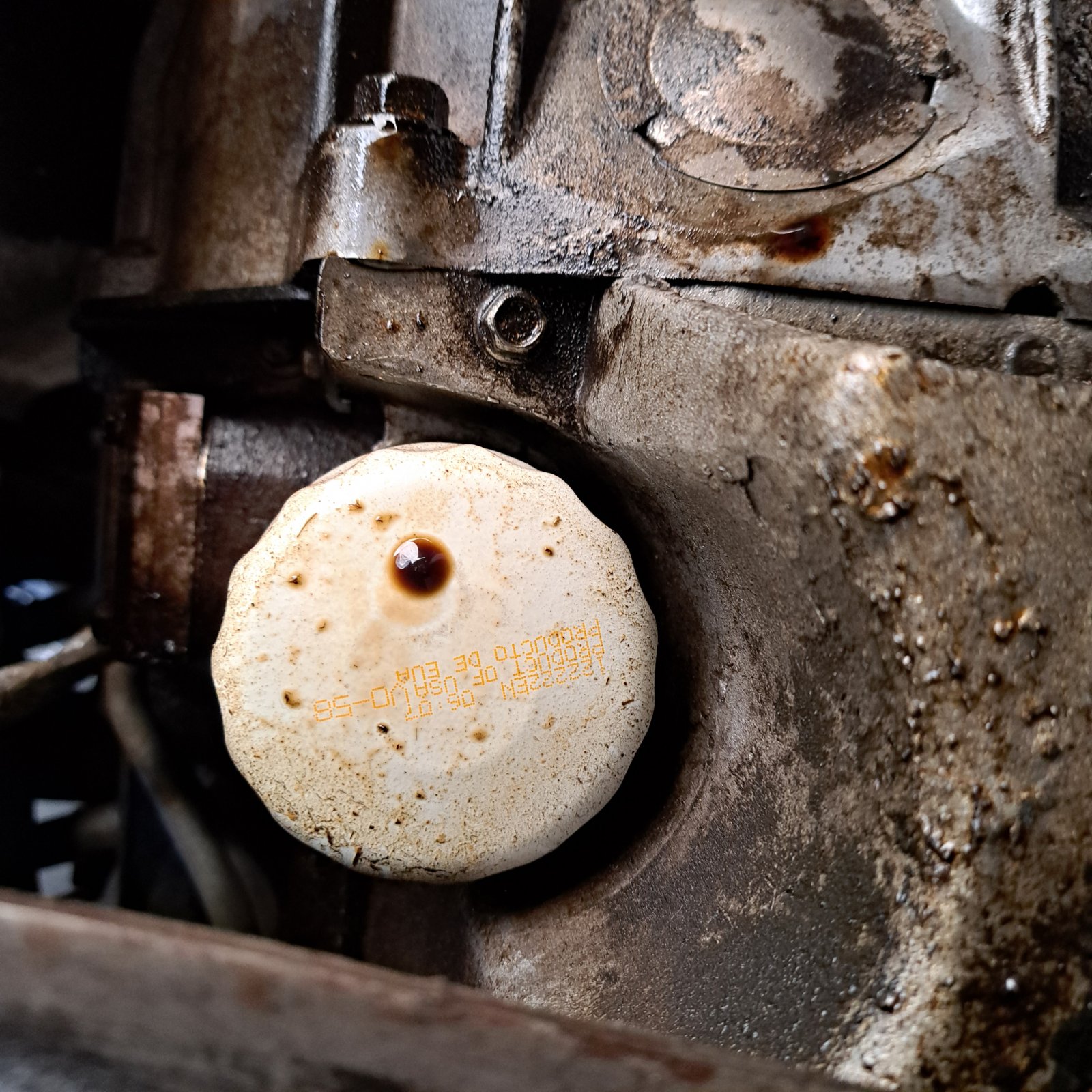

I crawled under the truck and found no leaks at either diff, axle seals, transmission and transfer case. I did find a seepage leak of coolant at the water pump. I did also see oil drop on bottom of oil filter but is coming from above and at back of engine. I could not see if was valve covers or intake from under the vehicle but did see a driver's side oil leak at side of the valve cover. I will just go ahead and tear it down and do the knock sensors and the valve cover gaskets at same time and am debating right now about plugs and wires, till I hear from you guys about the 41-985 question. I already knew, from looking from above, that the transmission and oil cooler lines are seeping fluid. The oil leak is definitely from above and not where the oil cooler lines attach at the engine.

Well, that tells me I am likely correct, that the 41-985 plugs in there now, are likely the original plugs. The plug wires show AC Delco stamping on them and not GM or Packard. That tells me that at one time, the owner did change out the wires. When I do the plugs, I will be doing wires at the same time. Thanks @Fless for clearing that up.
44,969
The brown on the plugs surely makes 'em look original. Also, and I can't be precise from a pic, but that gap looks large- indicative of wear from higher mileage.
