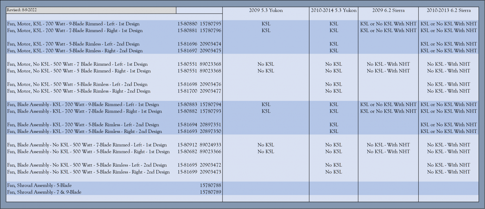

There are 3 relays that run both fans on the Low or High settings. Make sure they are all working and the fans. If you have the K5L RPO code on your glovebox door, your truck has 700 watt cooling fans. Otherwise, it has 500 watt fans.
