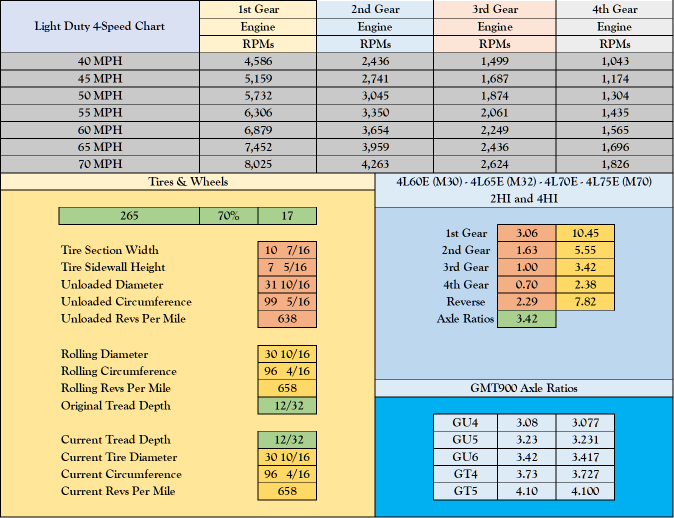

That's an excellent video. Thoroughly informative yet not too long and drawn out. I've seen it before years ago but forgot how good it was. Looking into a TrueTrac at this point and possibly re-gearing to 3.73's.
I've heard/read many say that's a pointless re-gear - if you're gonna do it, might as well go up to at least a 4.10 - but I think for my application it'll be well worth it.
It's a 2wd DD that just needs a little traction enhancement and some more oomph for the local hills around town. 3.42's are pretty disappointing, I can't believe they're putting even more anemic gearing than that in many trucks today. 3.23's, 3.08's, etc.
There are a number of other ways they could improve MPG without robbing a truck's torque output.
Do you have the 4L or 6L transmission? What size tires?
I have 3.42s on my 99 Silverado I swapped a 5.3 into. I have an axle I regeared with 4.10 but haven't swapped it yet. My 06 Suburban 2500 has 4.10 and I really like them. But on the lighter 1500 Silverado, I think 3.73s would be a bit better for an all-around gear. This is with the 4L80e on my trucks though and around 31" tires? LT265/75/16
On the 6L you split the OD gears in two, so Abit better.

3.73 is snappy enough and you won't loose much on highway drives if anything
07CLASSIC
Feb 23, 2025
42
25
Just installed a beefed-up 4L from Finish Line Trans, to replace the OEM 4L (Very happy with it.)
Roughly 32" on 20's.
Yeah, I'm hoping that's what the 3.73's will give me is a good all-around setup.
ETA: Especially with the addition of the TrueTrac.

Yes, slightly higher RPM on the highway. But it also puts your cruising RPM where you engine is capable of making more power, so throttle response is better and the engine can maintain speed with less downshifting.
Yeah, that guy with the snowplow truck had like 3.42 originally, then swapped a 4.10 rear end. So you just play around with different combinations of OD of tires for the front and the back with those 2 different gear ratios until your RPMs or speeds are close enough using those online calculators.
Like this one:
