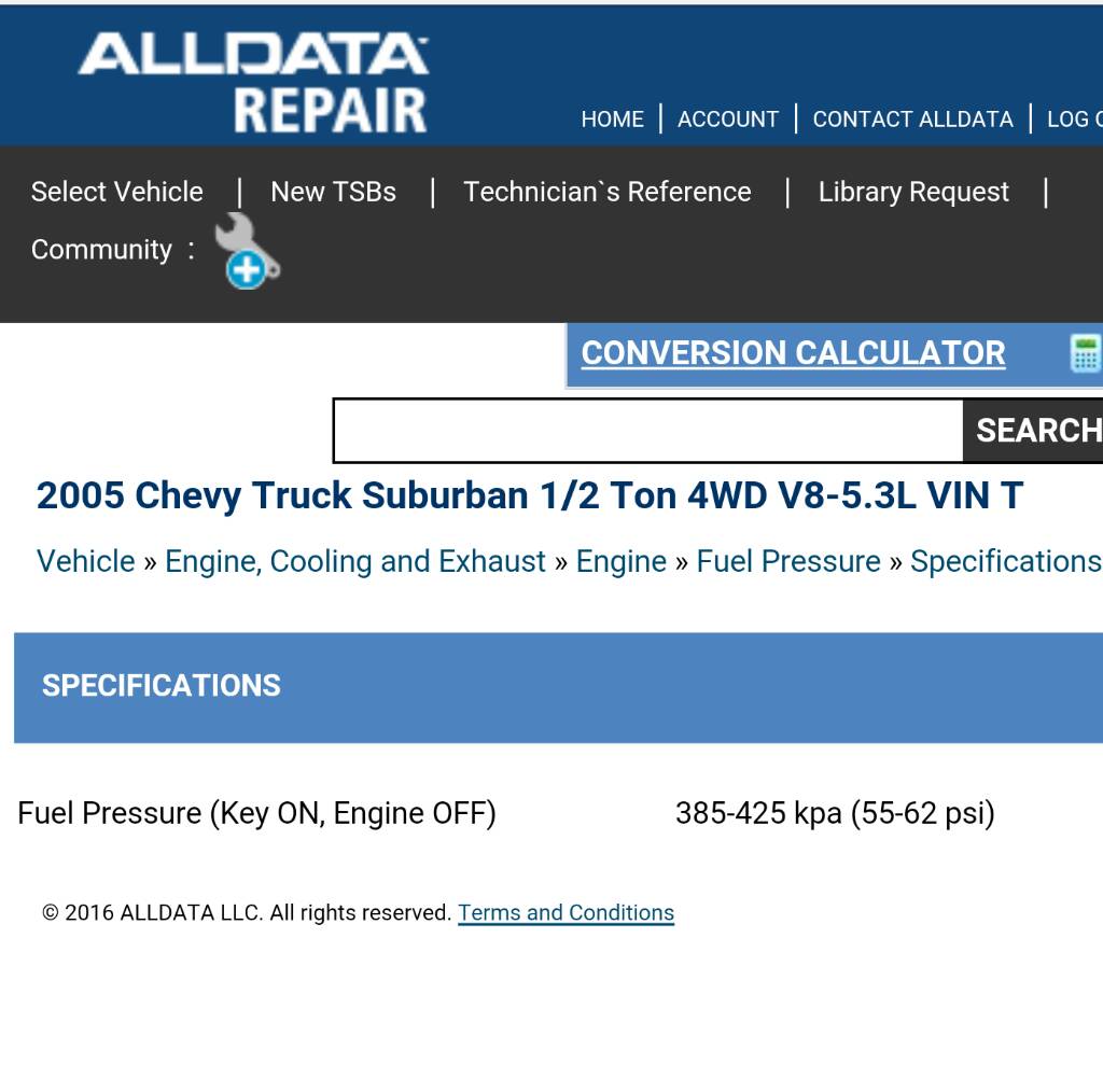

Fuel pressure is 42 at idle. Goes to about 50 @ 2000 rpm at load.
