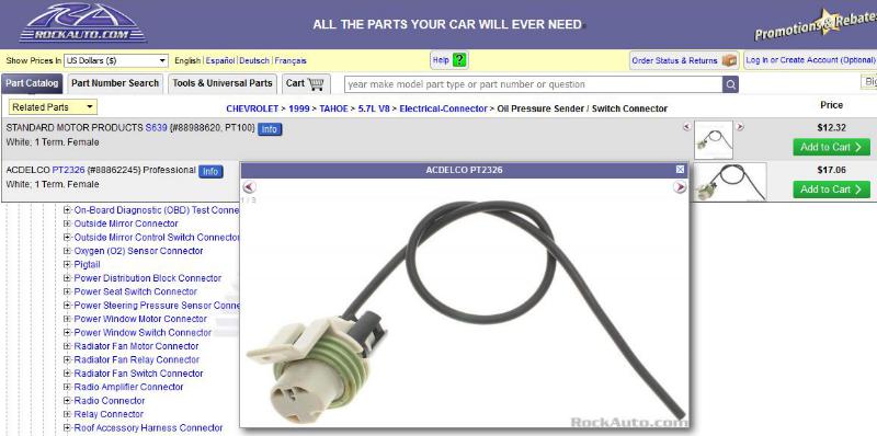

I may tear into the timing again then. But, before that, I did just notice a split in the insulation in the 1 wire for that camshaft position sensor.

You might do yourself well by replacing the can and crank sensors and make sure all wiring is intact. make sure when you plug wiring back in that the wire stays encased in the connector tab and does not push out of the connector.
It's a 1 pin connector, can't find anything like it on oreillys site.

Aren't the cam and crankshaft sensor connectors 3-pin?
Well I guess that means I'm taking the intake off cause that wasn't the camshaft connect lol. But I'm confused. It's bolted downwards on the back of the block, behind the intake, what else is back there that I could have grabbed?
