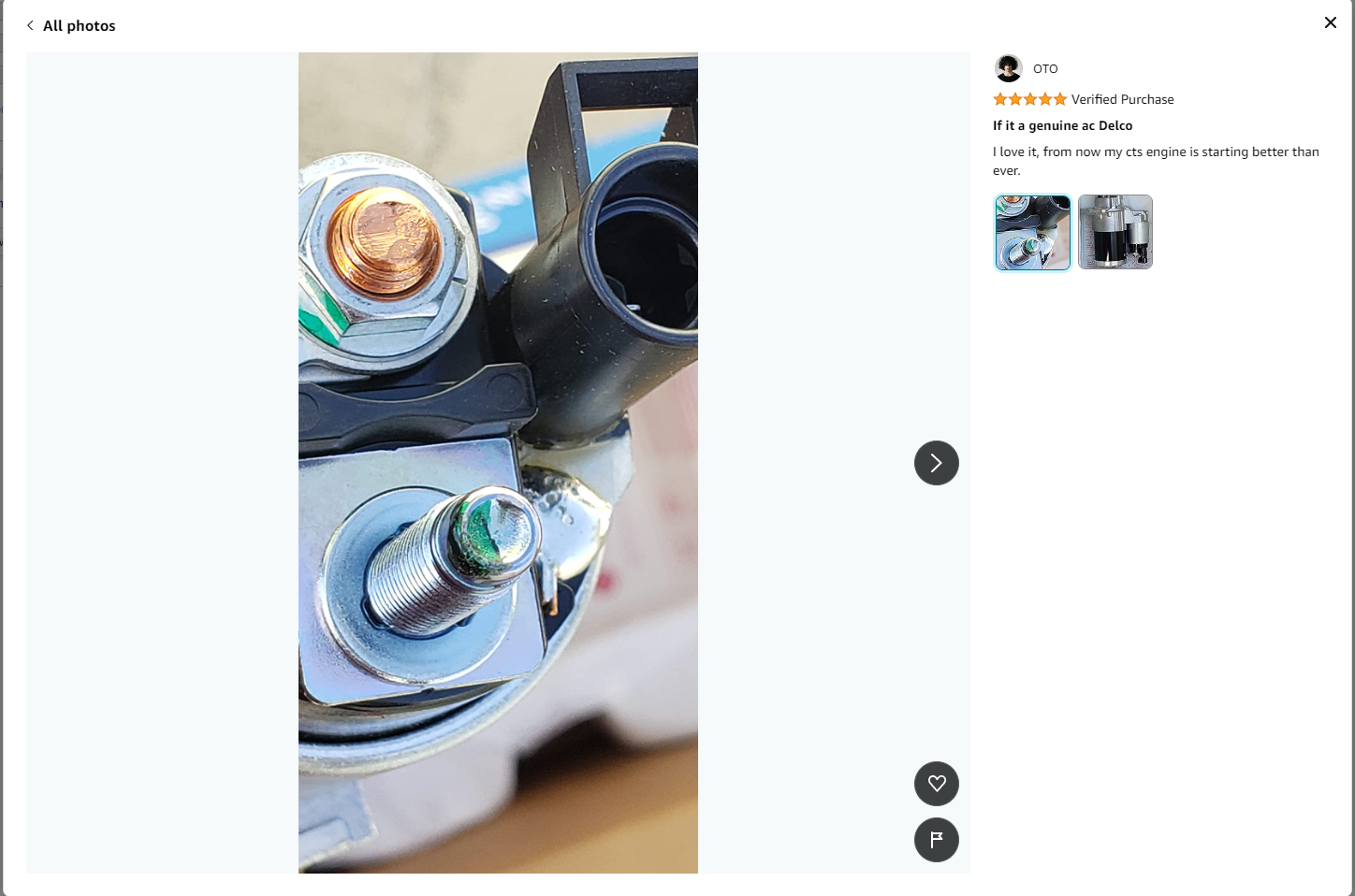

Anyone know if I can use any old washer or do I need the gm part?
I haven't seen any GM parts that match this, seems to just come with a new starter. I am just not sure if I can use any old washer or it has to be something specific.
I'll hit up napa tomorrow and see

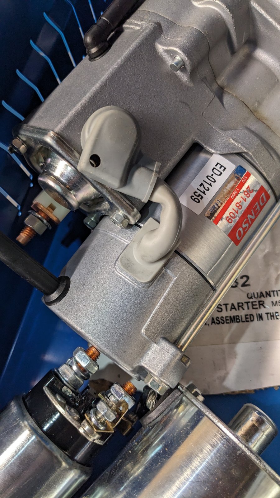

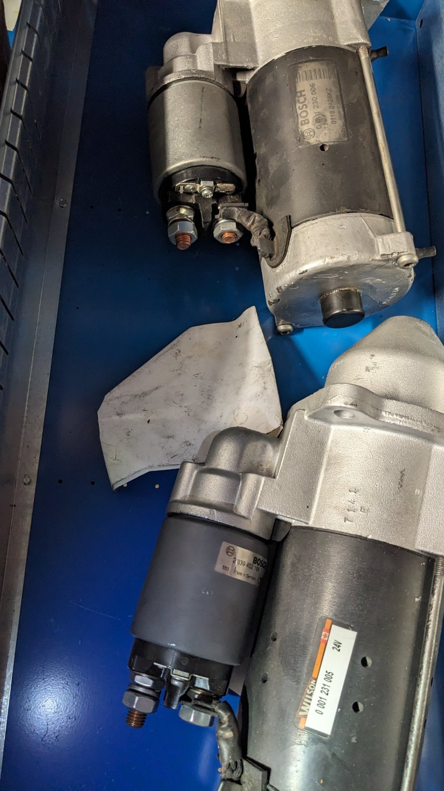

It’s probably made of copper. I have a full set of copper washers from horrible freight, so you could swing by there if needed.
