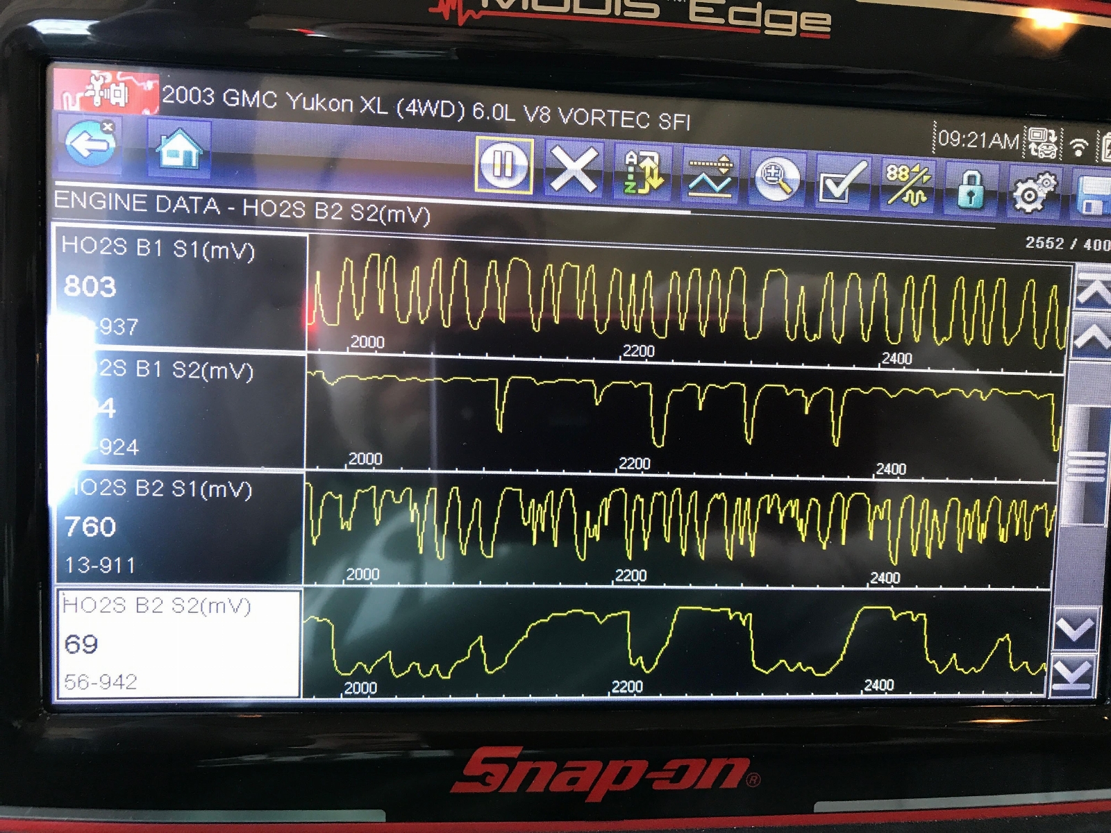

its the o2's that are reporting the cat code, they are what reads the exhaust gasses, so if one is lazy or gone bad, like you have a code for one, that could cause a cat code.
if your o2's are over 80,000 miles old, they could use replacing. they dont last forever. by 80k they are no longer as good as they could be.
Scottydoggs
Dec 16, 2017
2,741
4,167
NJ
But O2 sensors have their own codes for when they fail, this is what I do not understand.
just because theres no code dont mean they are 100% good. they wear out by 80k.
my regal had a new ac delco o2 installed, all seemed fine till 6 months later when i was getting kr for no reason. did a scan and found my o2 voltage was dropping to nothing wot, and that will mess up the fueling. changed that o2 out, no more kr. chased my tail for a week over that one. had no o2 codes either. but that o2 was bad for sure.
20,164
27,512
Ok, I've had degraded O2 sensors before, used to change them out all the time with the turbo Buicks. They just never set off codes other than a failed sensor code. Live and learn I reckon.
