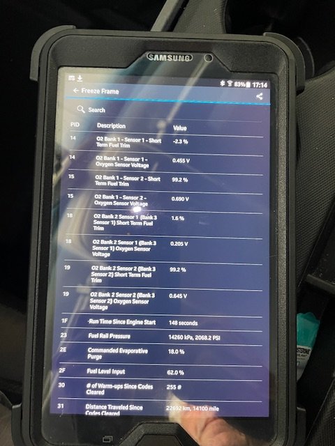

700 miles into driving from California to Florida. Got a CEL. Reader says P2099. Running rich on bank 2 post catalytic. Trying to see if we can keep the schedule or if stopping at a dealer would be better. ‘16 XL Denali - 37,000 miles. All dealers closed right now. Anyone seen this one? O2 sensor on right side looks fine, not loose, no wire chafing that I can see. Any suggestions?
