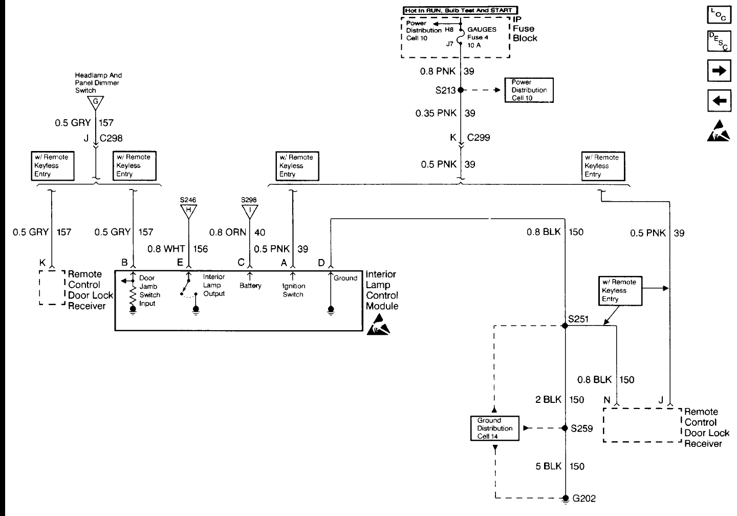

Here are the diagnostics from alldatadiy.com for a 1998 Tahoe with inoperable dome light. Hope it helps...
