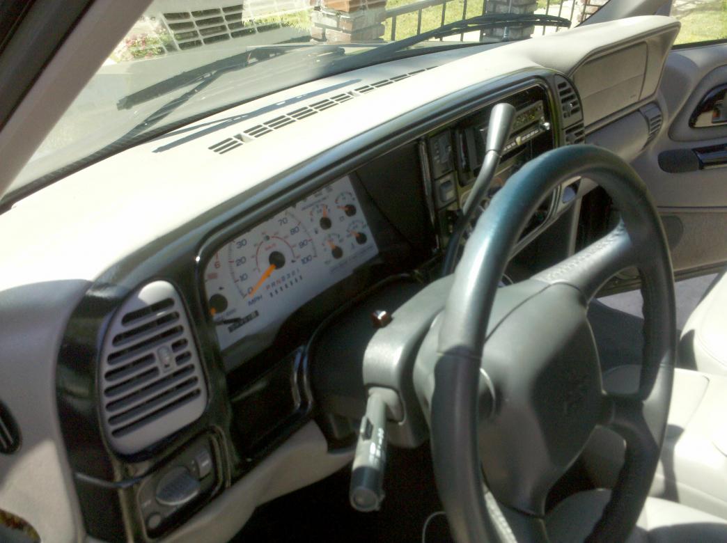

Heck I did the prep, but mine is a show truck so i had to do up right, all though i do have to admit it is time consuming if your going to sand it all down to make it smooth, if you want to keep the texture then just do a good cleaning on it and you should have no probs with flaking as long as it dosent get abused.
Here are a few pics of mine

I did prep it. I washed the crap out of it, and primed it very well with the krylon plastic paint. I wanted to retain the original texture so I didn't sand it. I'm not a horrible painter. I'm actually decent at it.
