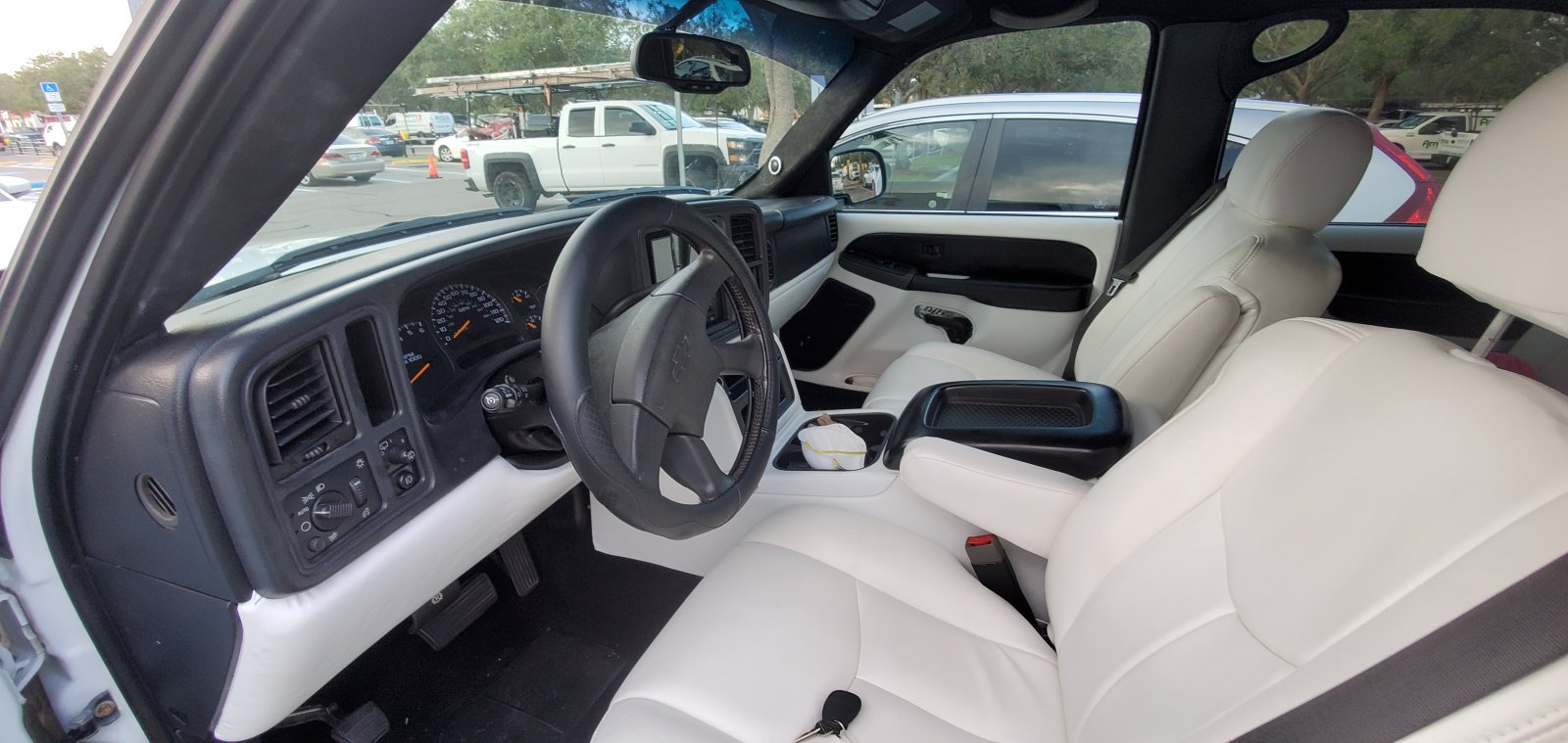

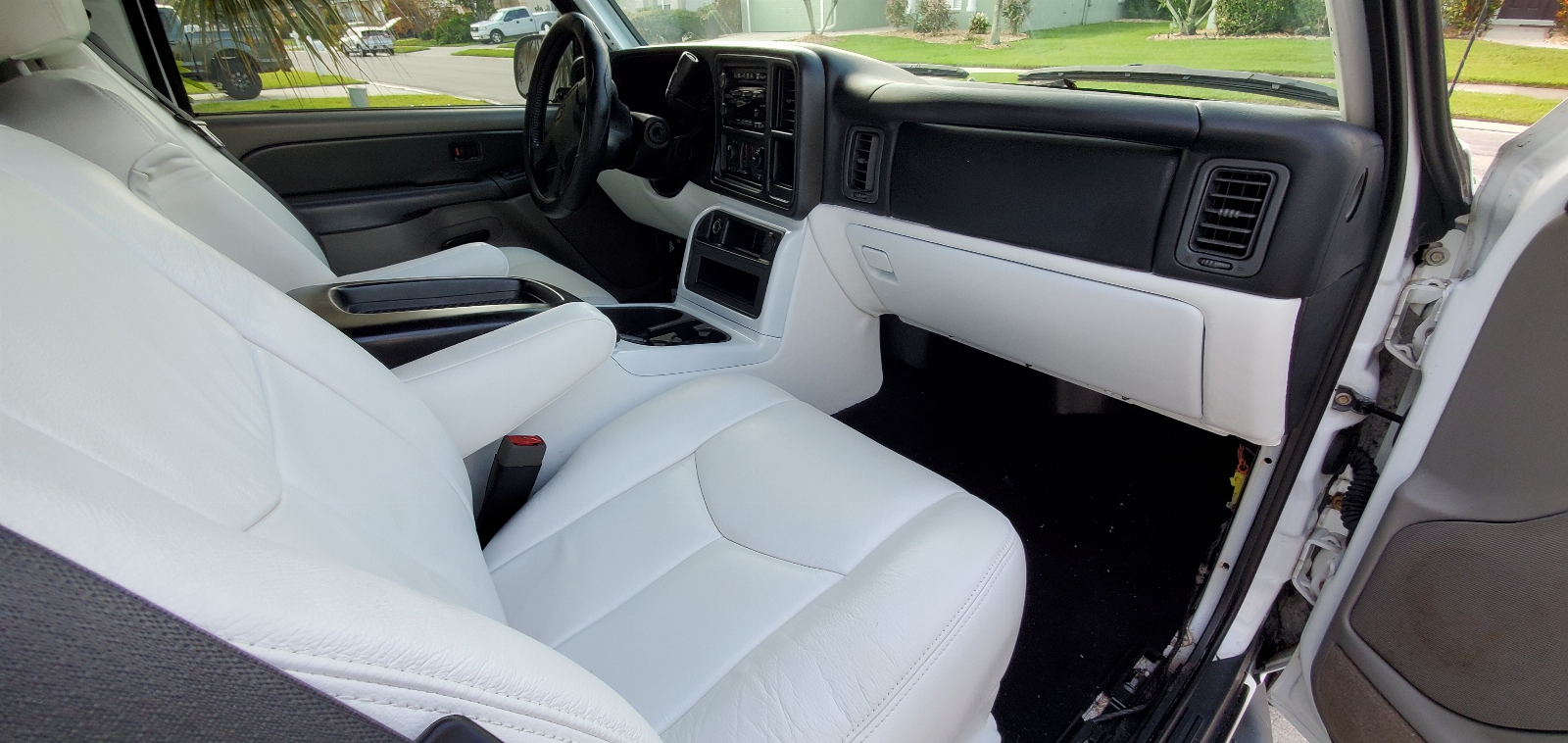

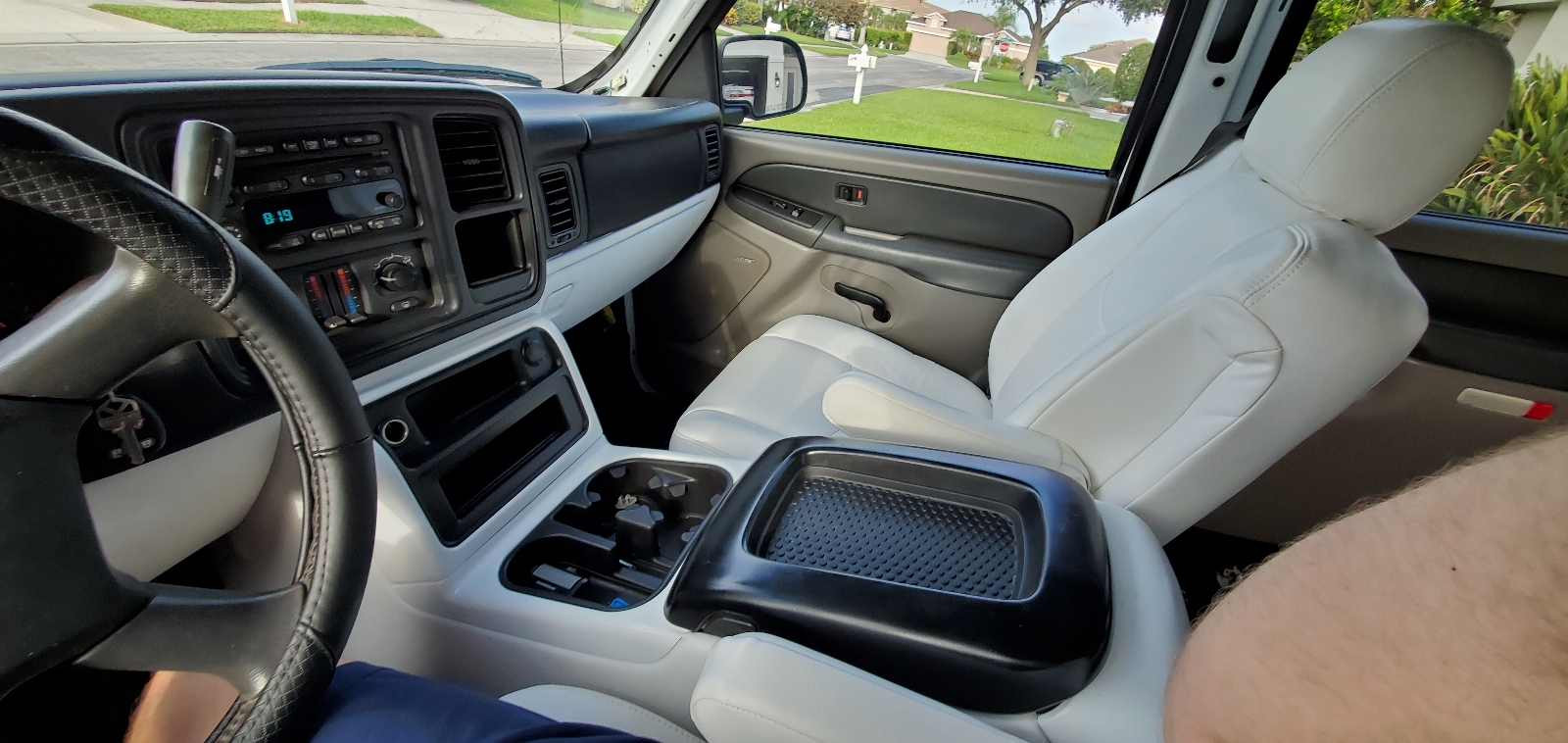

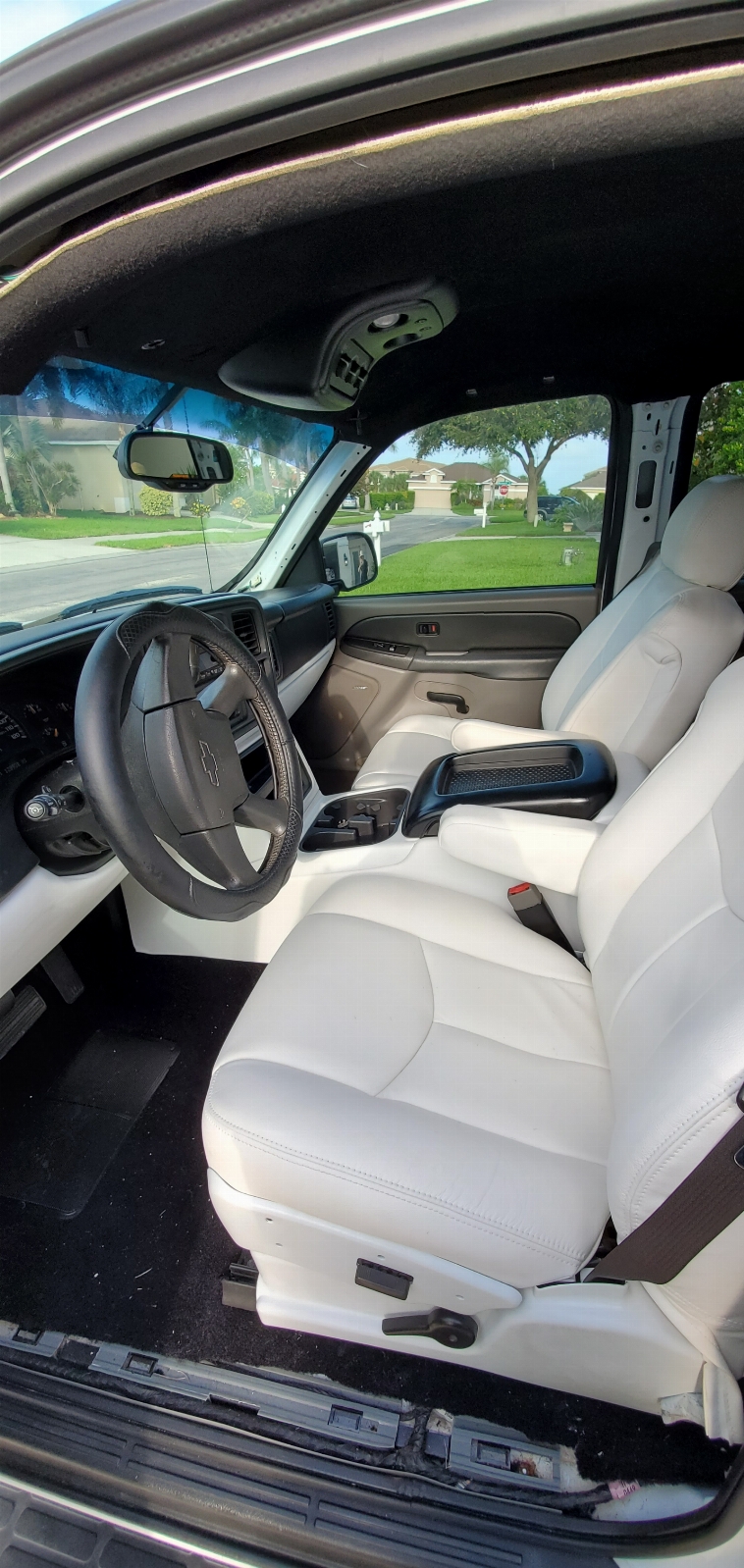

Curious as to why you did the clear since the OEM finish doesn’t have any. I’ve used the SEM Classic Coat without clear and it matched perfectly. Do you have pics? Here’s my dash in my 02 with SEM which is a perfect match and the interior in my 08 Silverado which has some original oem (dash) and some pieces done with Krylon Fusion flat black which I found is an exact match for GM’s Ebony because the SEM that’s supposed to match doesn’t.

That is weird, because I’ve done my dash in my 02 and 2 dashes for my 08 and never seen any “rubbery stuff”. The texture is part of the mold, it’s not added on top. I have used denatured alcohol and lacquer thinner with scotchbrite pads and never touched the texture. Maybe yours had been sanded down before and then they added texture out of a can. It’s the only thing I can think of.
