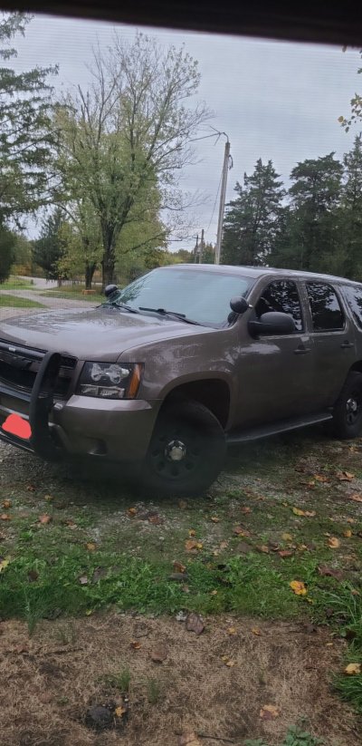

I have a 2014 Tahoe SSV I purchased a few months back. The passenger A Pillar (which is where the handle would be if I didn't have a spotlight) just kinda hangs loose. To the best of my knowledge you need a handle to tighten it down. But I have seen other tahoes out there with a passenger spotlight, and I'm sure they don't all have this issue. Any advice and help is much appreciated

There's usually a bolt at both the top and bottom of where the grab handle is that bolts through the trim into the A-pillar. Since your handle isn't there, are there still the mounting points for the handle where the bolts can go through?

There are, I didn't even try tightening it sheen without the handle because a tutorial on youtube made it seem like I needed it. Now I feel like such a fool. I'm gonna go to Ace or something and see if I can find bolts that fit, thank you so much.
