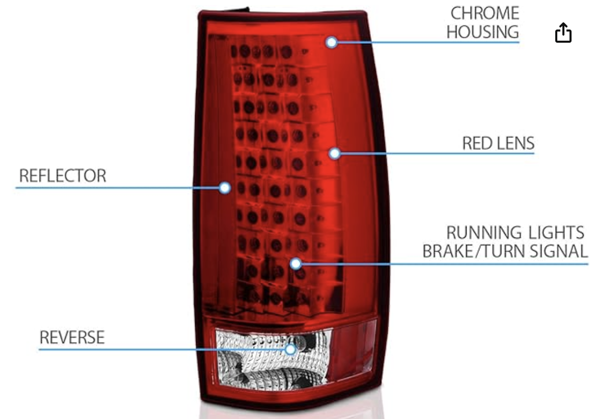

It's a whole LED housing but yeah, turn signal works and the LEDs are lit up when I turn the lights on, they just don't get brighter when I press the brake pedal and it's only the passenger side.

If they were inexpensive it’s time to replace it. Unfortunately you’ll have to buy the set (again). Moisture has probably contaminated the ICB that controls the brake light portion

It's a whole housing and the only bulb that is separate is the reverse light bulb. It's all plug and play. I was thinking it could be the brake switch but wouldn't all the brake lights not work if it was a faulty brake switch? The LEDs still work because the turn signal works and the tail lights still work. I checked the fuses with a fuse tester and they're good, but I may just replace them anyway.
