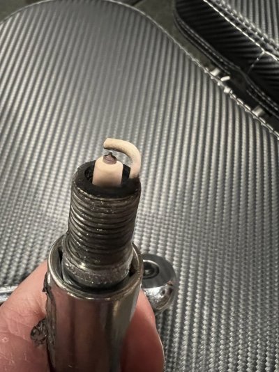

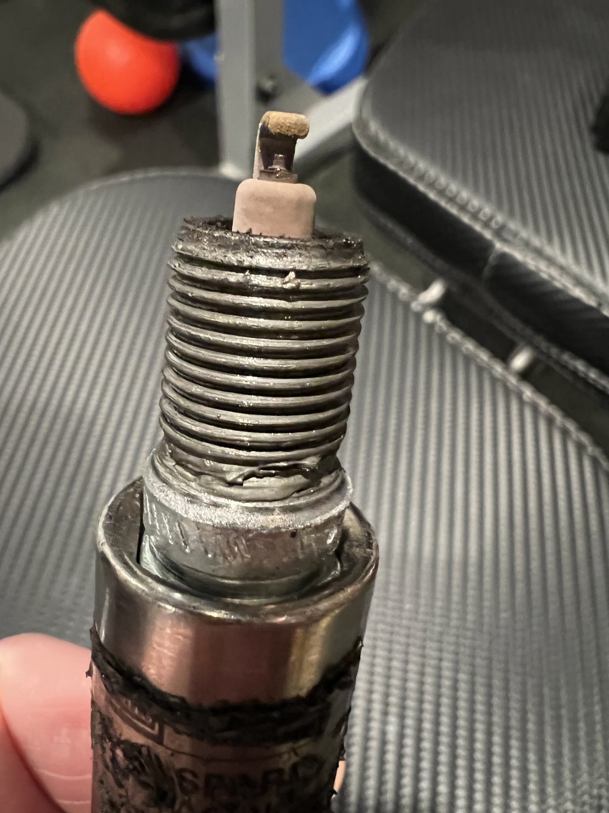

Well this isn’t good. Powdery white ground strap. I know these are supposed to be frugal with fuel but not this much. But explains a lot. Gonna go in and reset the fuel trims and alcohol percentage to see if it relearns.
