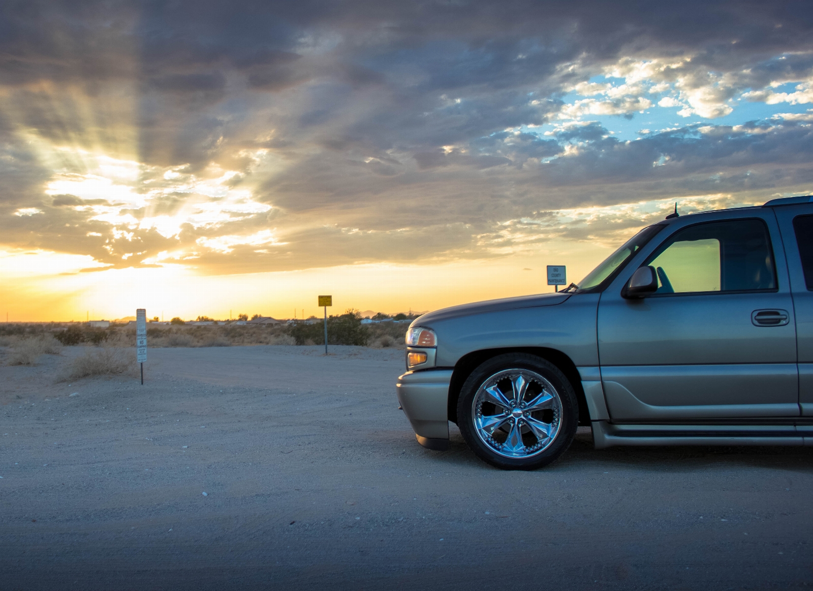

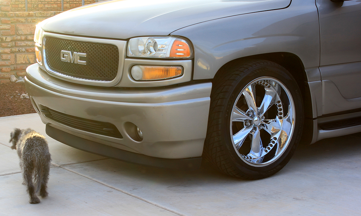

i plan on painting it so i have been mocking up paint schemes in photoshop.
this is what i am thinking.
BMW Black on top, GM Bermuda Blue on the bottom. The stripe and wheels stay Pewter Metallic.
realistically it wont be that low. i'm thinking just a 3/4 drop, but you know how that goes

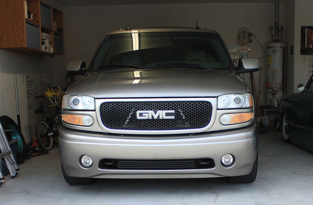

Looking at this photo, I think some nice black projectors would look nice with that paint job.
Perhaps something like this:
I'm thinking about getting a set for my truck, but in chrome.
nice. you know, i think that black shells look great on a light painted vehicle. since my goal is a dark paint scheme, i think the contrast of the chrome shells works more in favor. But i like both looks!
