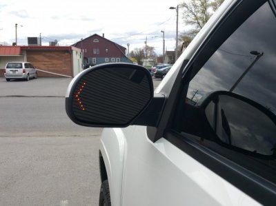

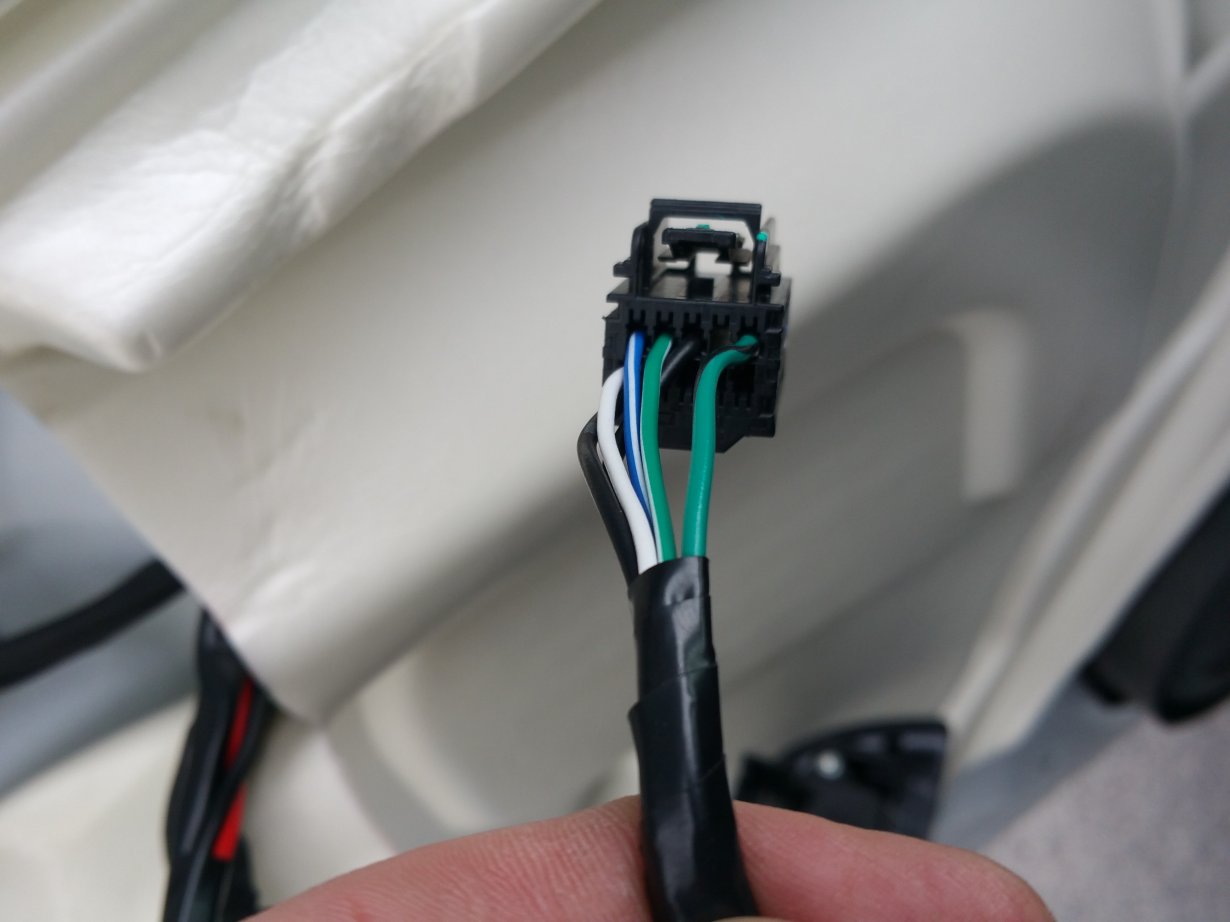

Just added led turn signals and thought I would share my findings. Couldn't find any direct info on this.
The cars are pre wired for turn signals as many of you know with the plug you have in the truck. Just needs a wire inserted into the empty spot. I had some left over pins from another project to use. It is pin 5 in the black plug coming from your current mirror. It is 12v+ and there is a larger gauge black wire you can use for ground off of the window switch.
The ones I got are like the one in the pic but mine have 9 leds
