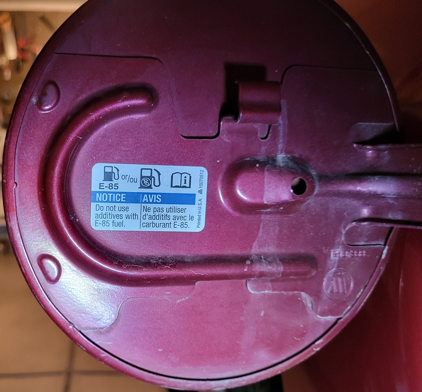

no CEL on or flashing...no codes viewed from several scans with my BlueDriver scanner...thanks guys...the only time I have heard the pinging is 3 times in 700 miles now and only when I did the WOT/flattened the gas pedal on the highway...and it doesn't do this continually

the page quoted from the Owners Manual by wjburken shows that GM recommends 87 octane for the 6.0 LQ4...
I have no problem using higher octane or paying more for it but the Owners Manual states this small issue is normal...this is the reason I asked here as I am new to this particular GMT800 but not to GM (or other) V8 engines...

the LQ9 engine requires higher octane but not the LQ4 which I have...there is no sticker nor mention of using anything higher than 87 octane in my owners manual unless there is heavy knocking which I am not getting
