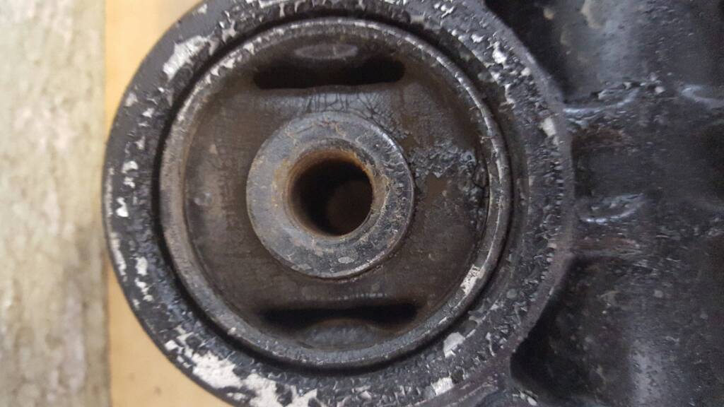

Center bushing on the rack is shot. I'm on my forth rack.
Turn the wheel full lock. Then observe the rack. If it mooves it's shot. I have threads on here about it of you search.

I'm curious. Has anyone tried pressing these bushings out and replacing them? I can't find replacements on-line anywhere but there has to be a replacement out there somewhere.
Nov 19, 2015
46
13
people have gone to gm and even they dont offer the bushings. they dont want you to press them in. a reman rack is about $160 from rockauto, not terrible but more than bushings. Maybe dorman will come out with some someday
