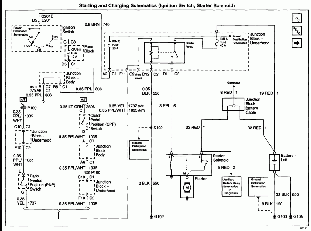

If you are sure you have a good gauge and it is hooked up correctly then either your pump is toast, pump is not getting power or pump has a bad ground.
Here is your fuel pump circuit. You can double check for power and ground but I would bet on the pump

Ever get it figured out? mine did the exact same to me fri, im 99% sure its the pump, gonna pressure test tonight and if it is no pressure dropping tank tomorrow. Anybody know where to check the pump ground?
