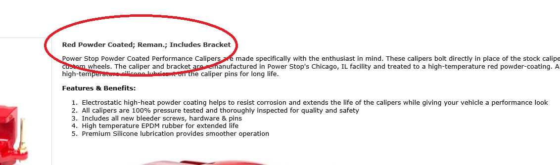

In the process of sourcing all of the necessary parts, I stumbled upon this entire kit, and wondering what everyone’s thoughts are:
Power Stop (KC2069) Z23 Evolution Sport Brake Kit with Calipers, Front https://www.amazon.com/dp/B00KT5BR4O/ref=cm_sw_r_sms_tai_6Ug5EbP3XC4J7
This kit includes everything necessary for the upgrade (even the shims), except for the stainless steal brake lines.
Does anyone have an idea of ow this kit would compare to the AC Delco NNBS retrofit kit?

NNBS kit:
Power Stop rotors (AR8654XPR) $143
NNBS AC Delco left caliper 18FR2247 $50
NNBS AC Delco right caliper 18FR2246 $50
EBC Brake Pads Series 7000 $83
Goodridge SS brake lines (14175) $133
Total: $459
VS
Power Stop Kit:
Complete kit (KC2069) Z23: $400
Goodridge SS lines $133
Total: $533
(and already painted red)
