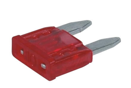

thats why for small stuff, remote turn on leads, radar detectors. I use the fuse taps. Makes it much easier to find a switched fuse with a test light than guessing at wires under the dash....
where do you buy these and how do you test which ones you can use?

I usually get them at autozone the minis are a bit harder to find but they are there.
I usually just take a test light and for example the radio circuit is switched but to double check touch the test light to the top of the fuse. if you look real close there is a little metal part on either side and they will tell you if its got power.
Now with the car on if it lights up it maybe be switch. When you shut off the power it shouldn't light up if it dose then it isn't switched it constant.
