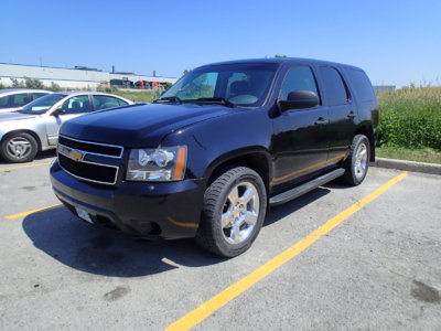

Here's how mine now looks with 20" Silverado rims.
The police type I'll keep for winter.........
