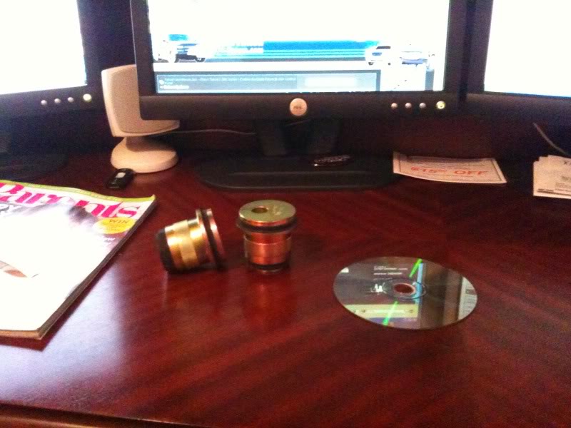

who else sells a upper a arm? After almost 10 years of dropping these trucks ive seen it all. Rather do it right from the start allthough the camber bushings by bellltech might fix it also.
