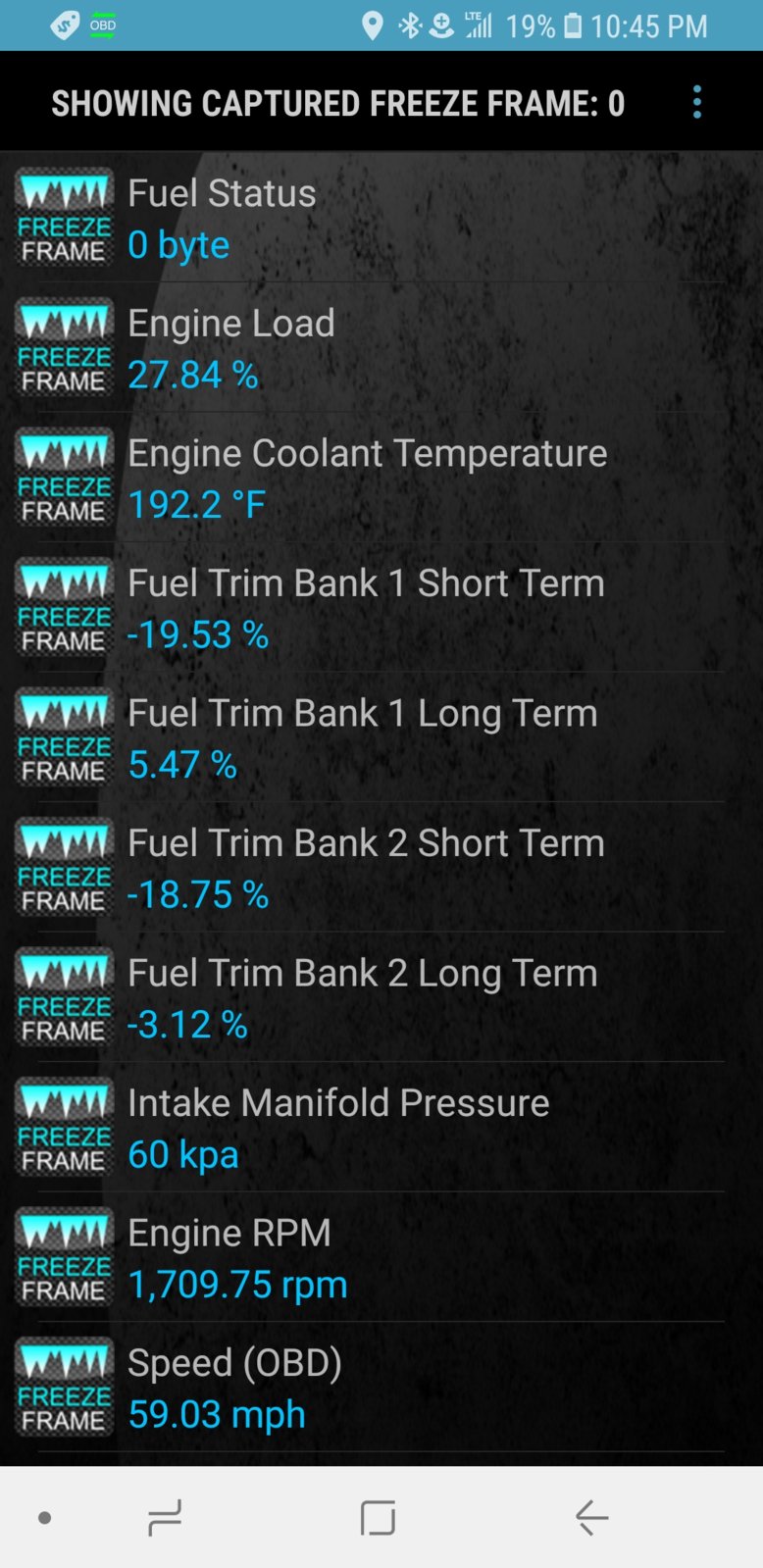

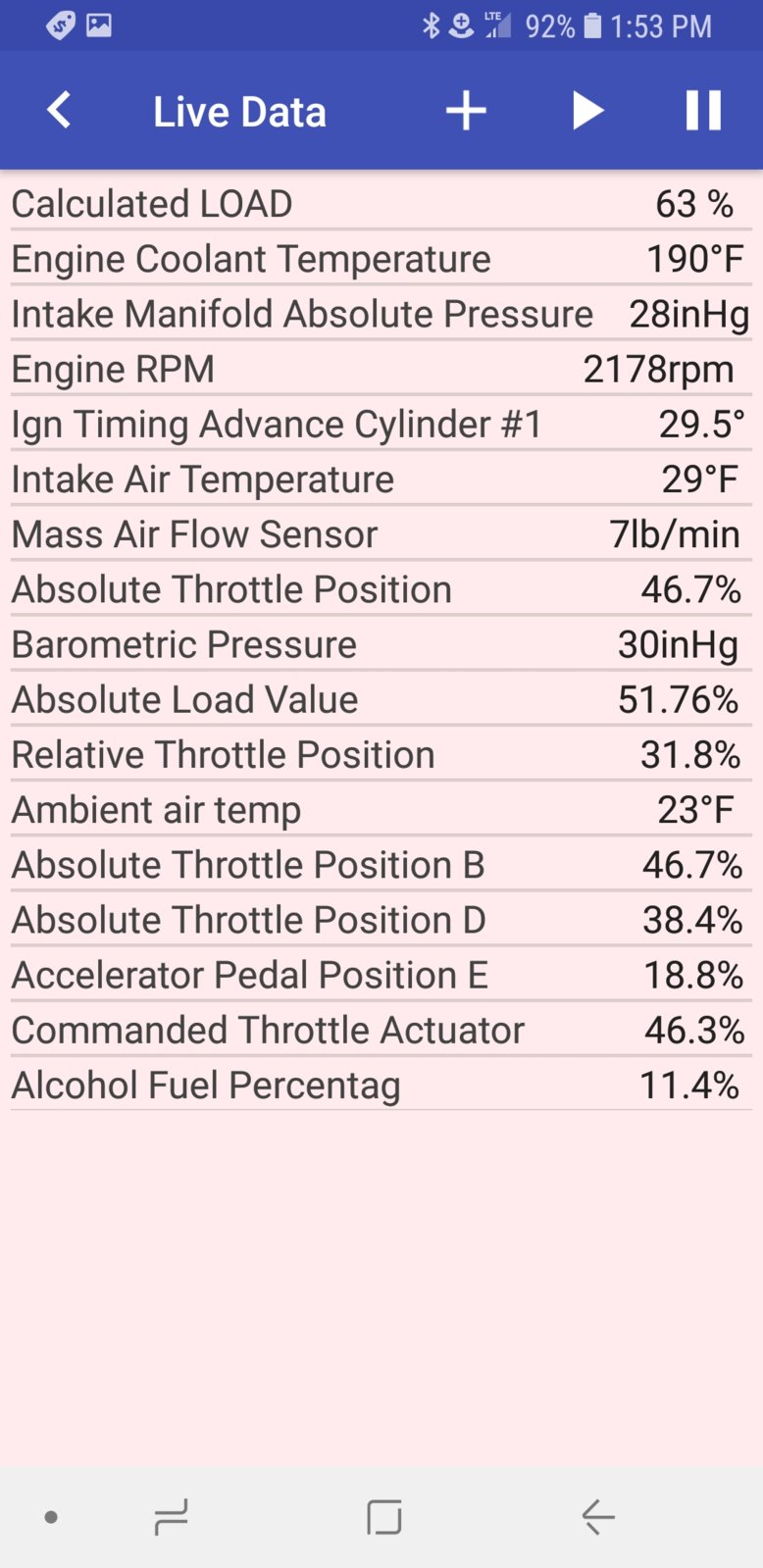

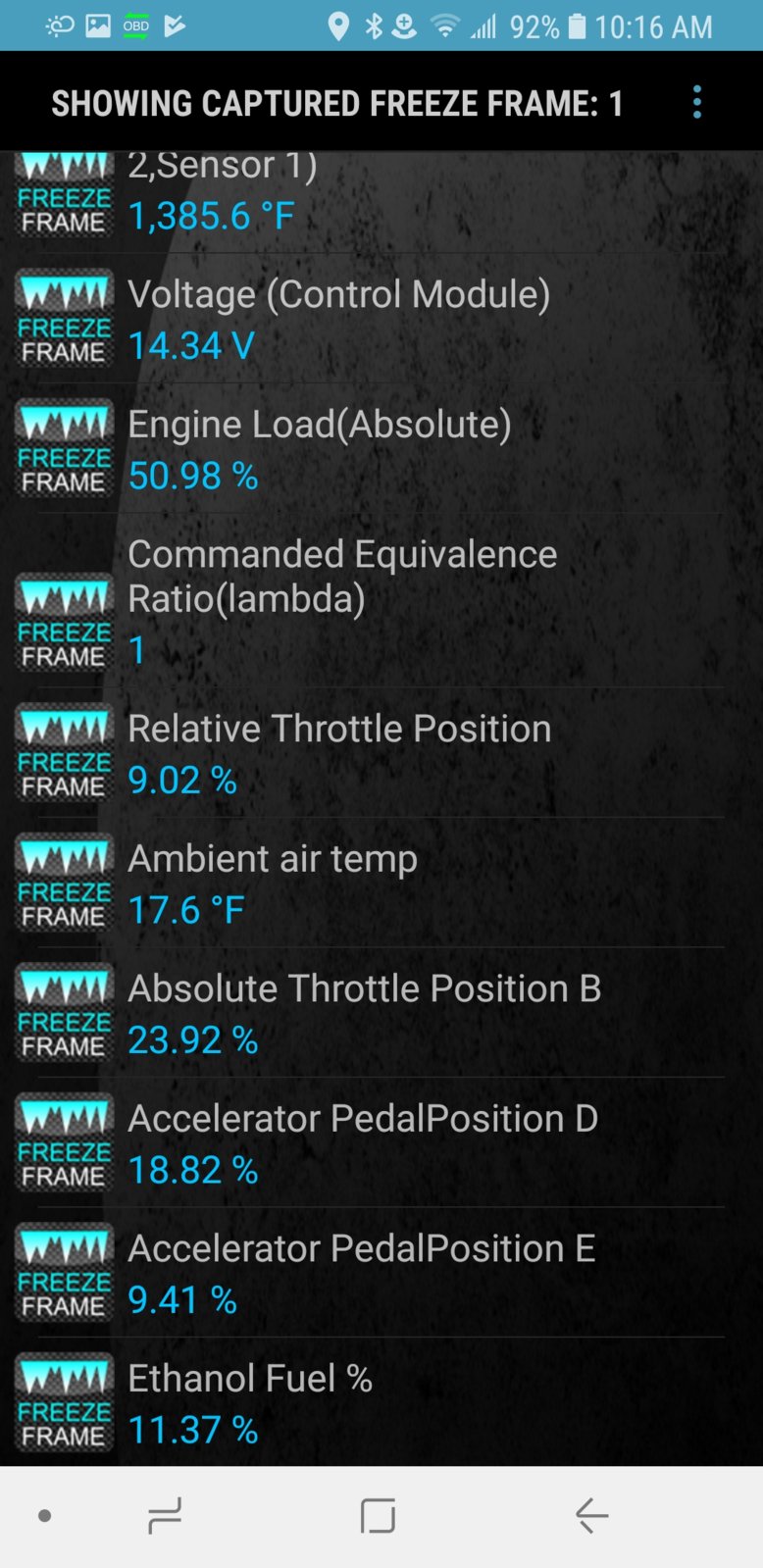

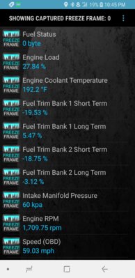

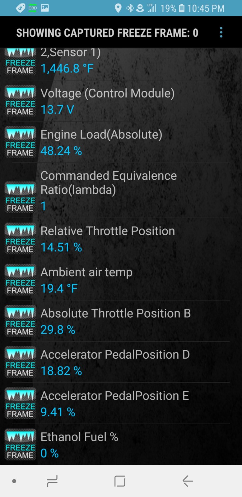

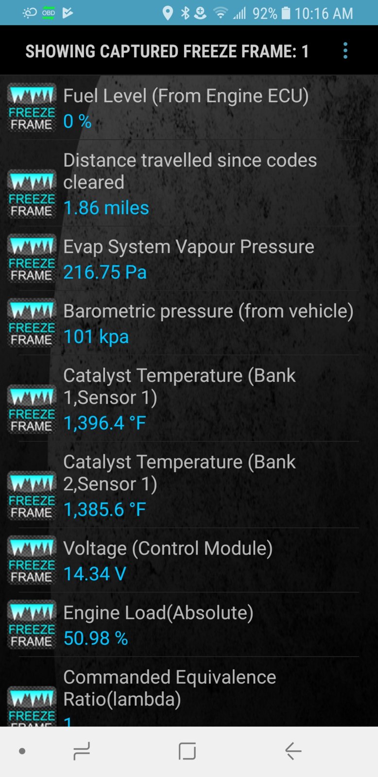

Took the truck to get coffee this am and reduced engine power came on p0068 and this is the freeze frame. Didn't get a chance to mess with oil pressure sensor or map sensor yet.
21,287
30,225
The throttle body is not liking the numbers coming from the MAP and MAF sensors in relation to the throttle plate position.
While observing your MAP and MAF readings, idle up slowly and smoothly to 3000 rpms and then back down again. Both the MAF and MAP should increase and come down smoothly and gradually.
Also make sure of leaks as I mentioned earlier, check the throttle plate for being loose, busted shaft, etc.
