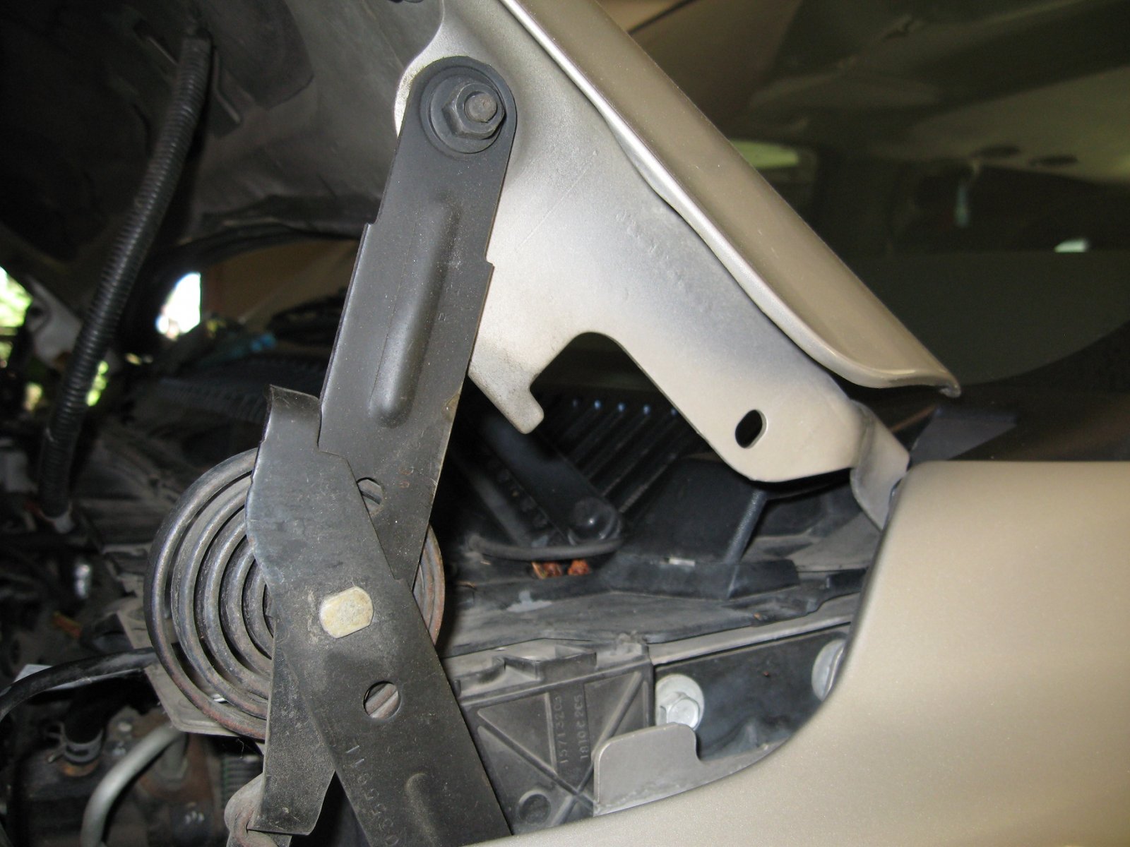

Yes , problem is it's only myself doing the work, my son just had an appendectomy so he's out for 4 weeks.
There is a second bolt hole on the plate that attaches directly to the hood. I believe some mechanic's unbolt the pivot on the spring mechanism and move the attachment to the second hole to render the hood vertical.

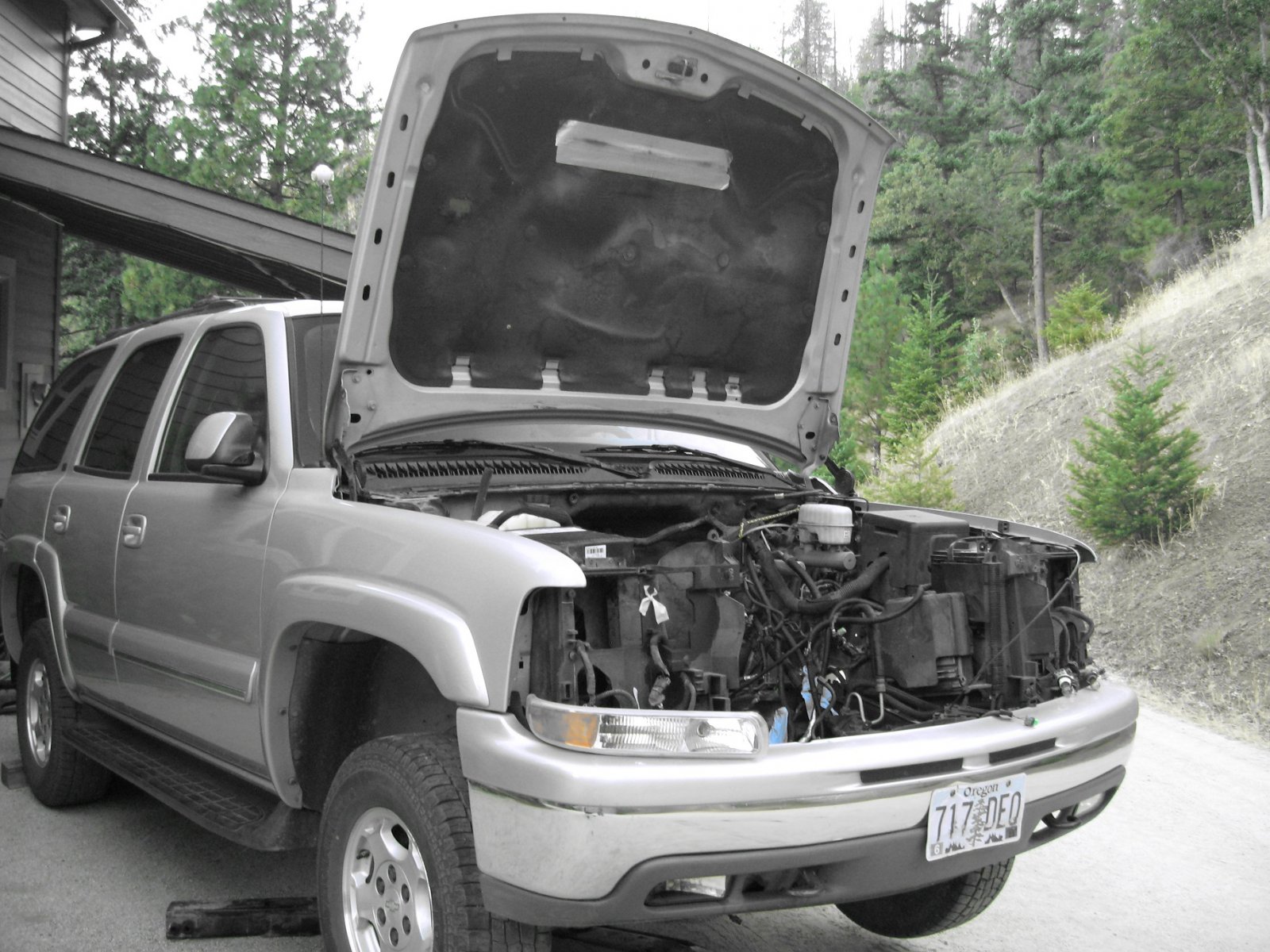

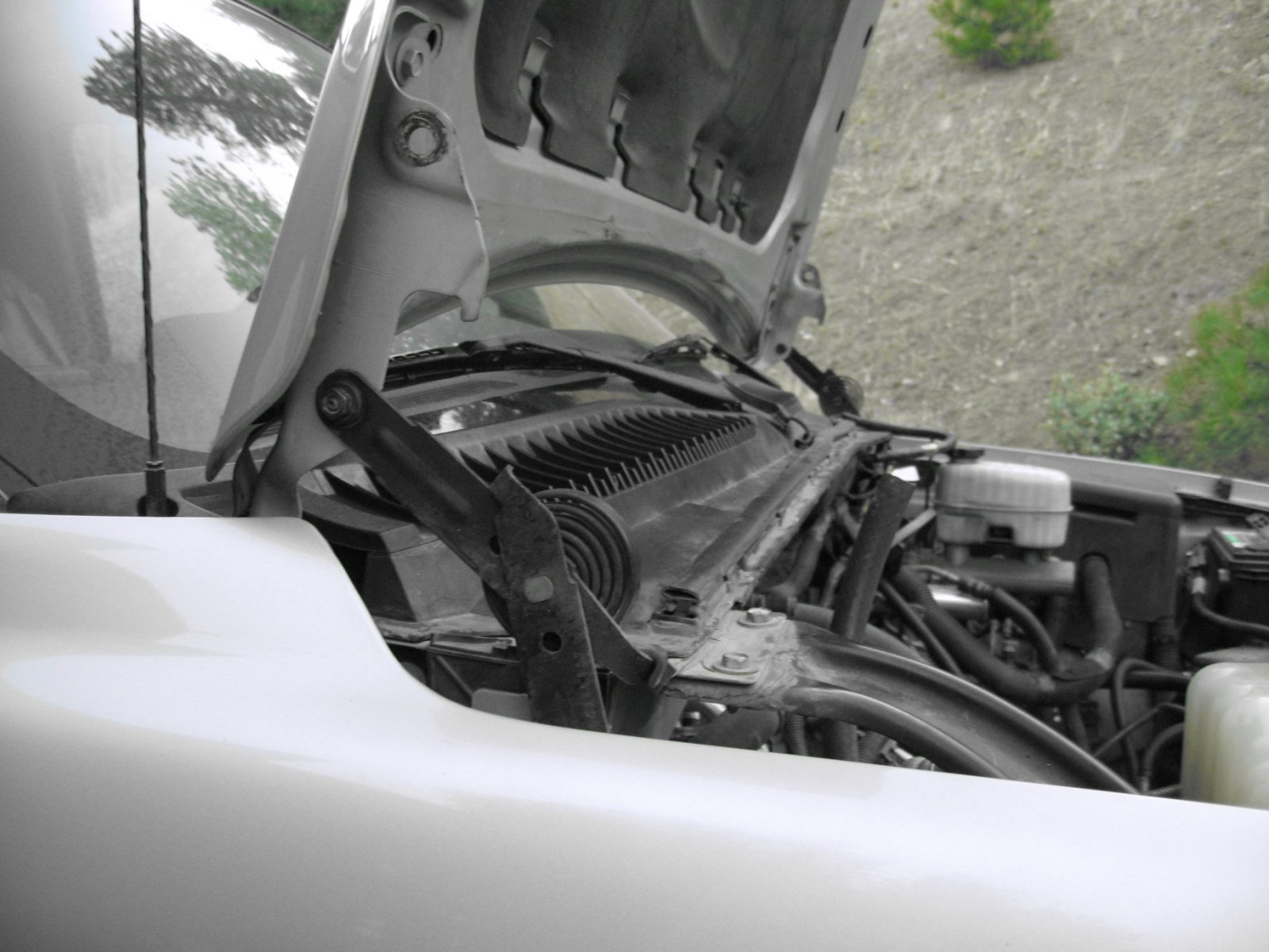

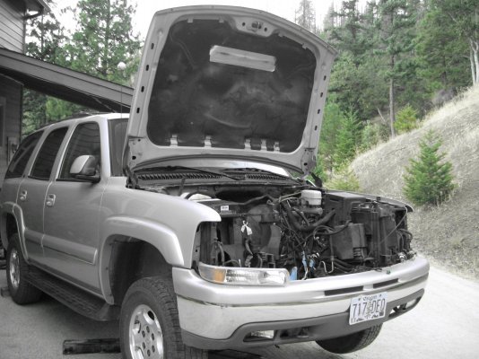

The trick actually worked and easy on the back. It supports itself just fine, just need two people, one to hold the hood, the other to replace the bolts.
I wouldn't try closing the hood in the setup though, and it might not work inside an 8' ceiling garage.
