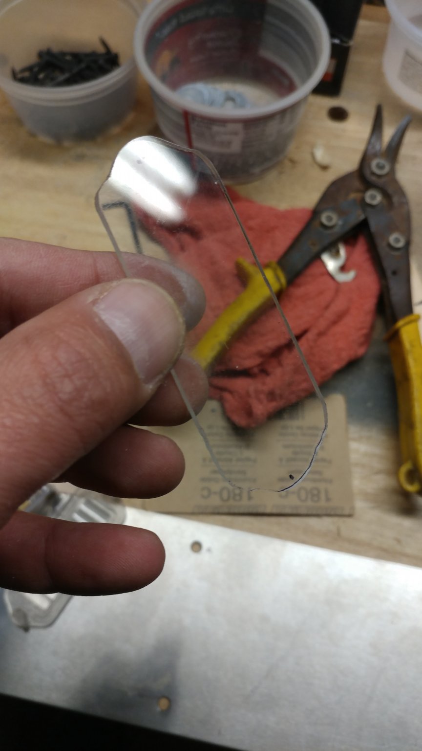

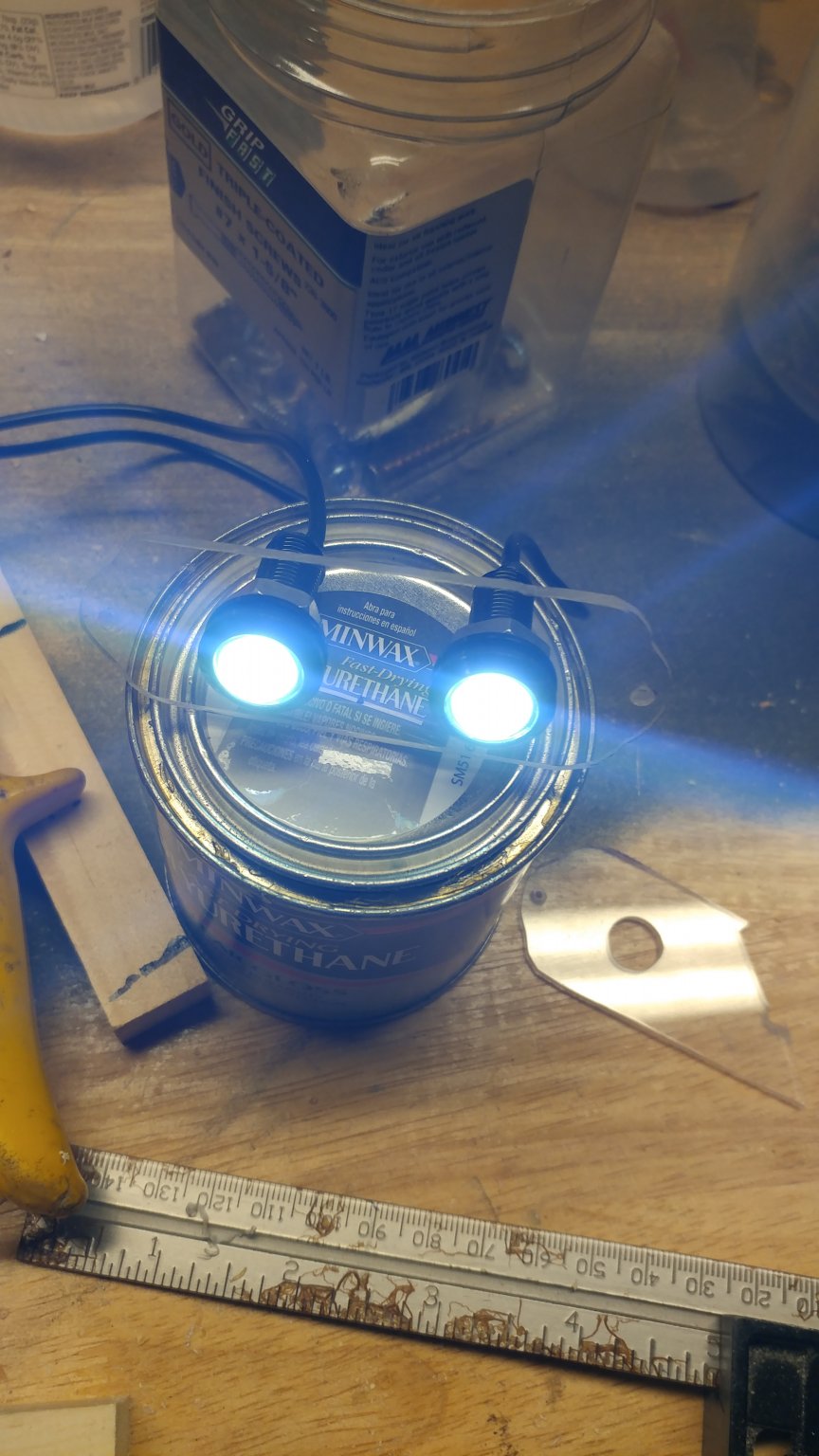

So after a few attempts cutting stainless. I quickly learned i did not have the right equipment to make those detail cuts. I turned to some thin plexiglass i had. I traced from the OEM light. cut with a scroll saw ( fyi larger teeth ) and had the blank shape.

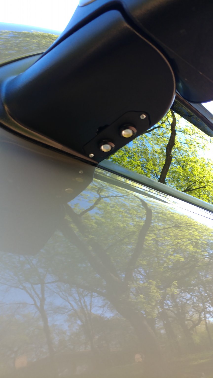

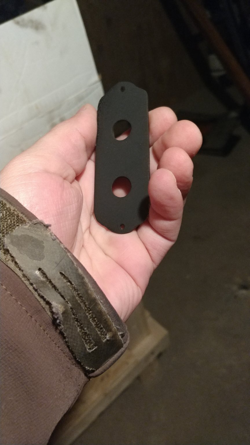

Next came some trial and error with a file. I wanted it to fit as tight as possible. once i got that, i decided i will be screwing it into the tabs inside the mirror housing. only issue i am not sure about yet is the shape of the door might make it tricky to get the inside screw in. Here are some progress pictures. I just need to pick up a few things to finish up.lens shape.jpg

I did want to add. a single led would probably do the trick. but i bought a 10 pack. so why not.

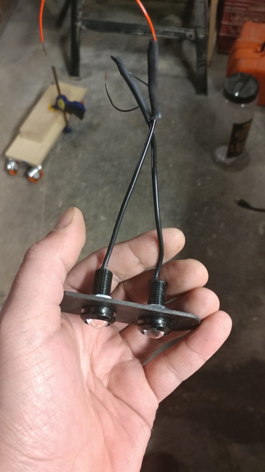

i got everything all soldered together and shrink wrapped. i need to either get the plugs that fit the factory wires, or harvest them off the oem lenses. once thats done i can install.
