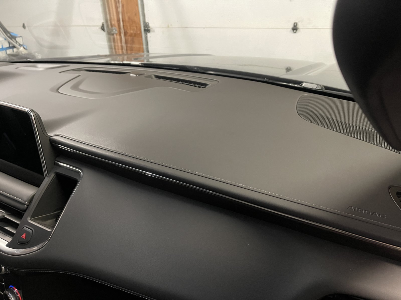

Another day, another few quality issues. First two pics are the tint issue/air bubble on rear passenger window I described in an earlier post. 2nd set of pics is the dashboard on passenger side...air bags?
